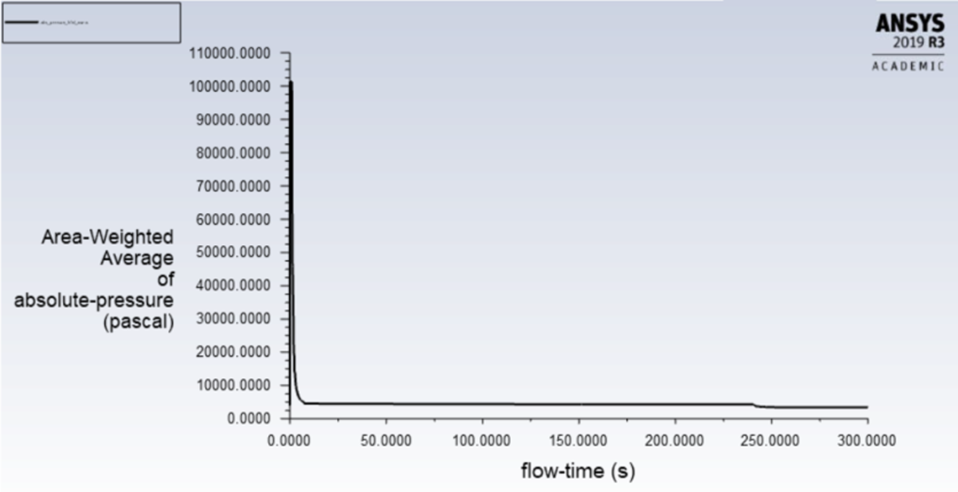

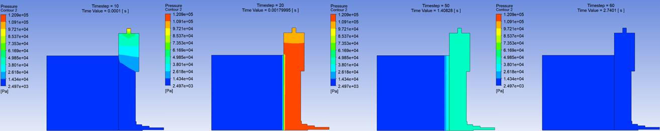

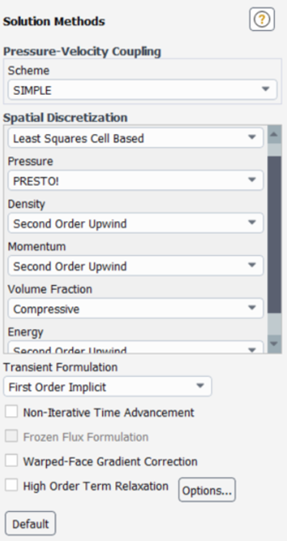

      I still have problems with initialization / patching!nYesterday I initialized my Inlet as a pressure-inlet with 1 bar and defined an event to close the inlet (by changing the BC type to wall) after t=1s.nThen I patched in this order (without closing the patch dialog box - no idea if that changes anything?!):n1/ Electrolyte volume fraction = 1 &n2/ Pressure = 101325 Pa.nnI simulated for 5mins (physical time) using these adaptive time-stepping settings:nnThe result of the absolute pressure distribution is still confusing to me...nFrom left to right one can see times 0.0001 s, 0.00179995 s, 1.40828 s and 2.7401s and the corresponding absolute pressures.nObviously, after 1 s - when the inlet BC is changed to a wall BC - the pressure drops immediately.nThe following plot shows the absolute pressure of the inlet face:nFrom experimental data I know, that in reality, the pressure at the inlet drops only slightly below 1 bar (around 800 mbar) within approx. 1 hour (and not within seconds).nHow can it be that the pressure drops that fast considering that the left zone is a porous zone and inhibiting the liquid flow furthermore?n
