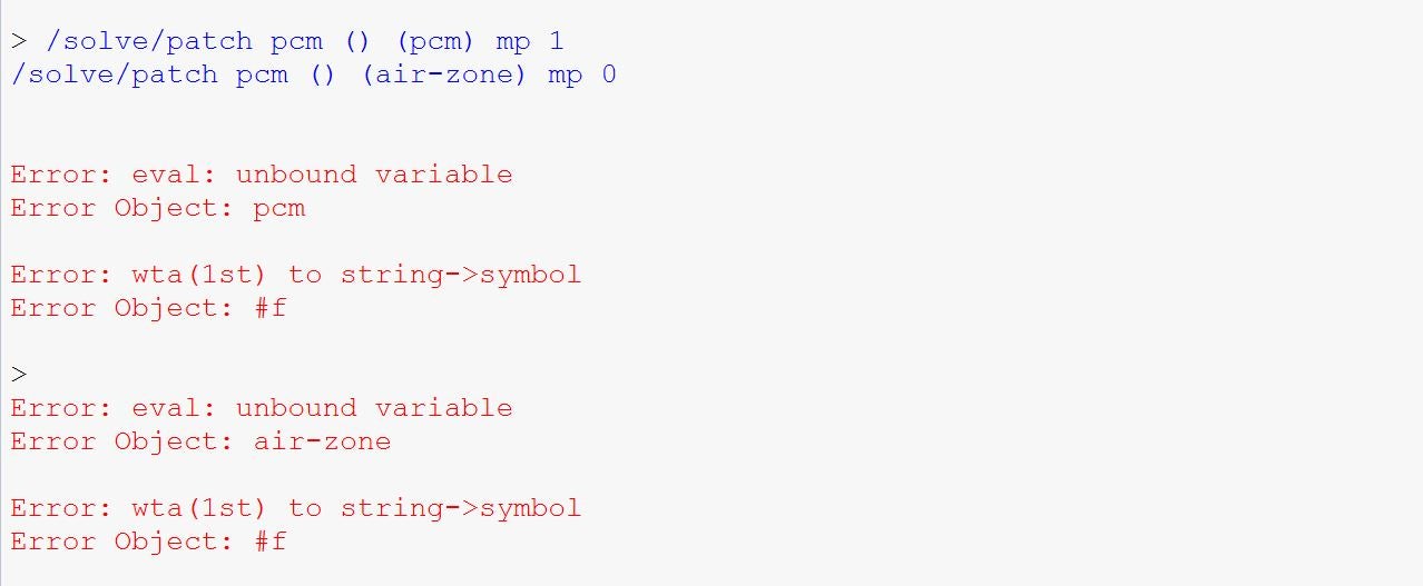

      I am running a VOF-3D-case in ANSYS FLUENT 2021 version which consists of an inlet and an air region on top of a PCM region. My goal is to melt the PCM as water enters from the inlet. I am trying to patch the air and the pcm, but I have been getting some errors attached below. Please, does anyone have an idea how I can patch this correctly? I need to run this with a journal file because of how large the output files are. When I try running it with a jou file, I get the error shown below.

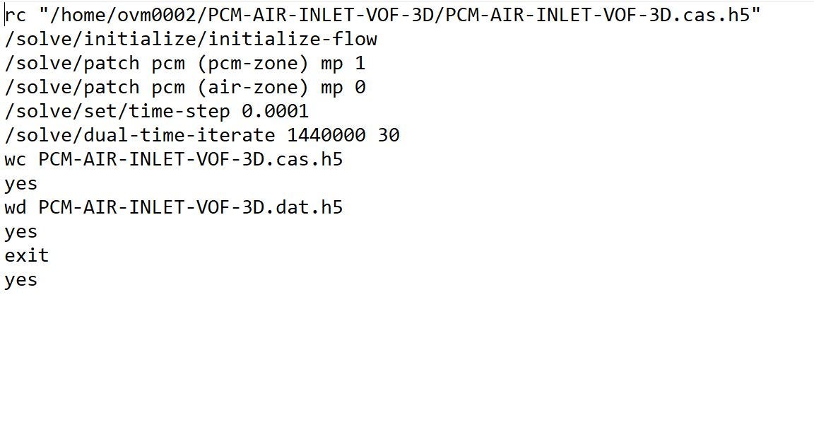

      It works well on the GUI, but I need to run it with a journal file. Please, can someone assist me with this? Attached also is a picture of the journal file.
      Error: eval: unbound variable
      Error Object: pcm-zone
      Error Object: mp
      Error Object: /solve/patch
      Error Object: pcm
      Error Object: air-zone
      Error Object: mp
      Error Object: /solve/set/time-step
      Error Object: /solve/dual-time-iterate
      Error Object: wc
      Error Object: pcm-air-inlet-vof-3d.cas.h5
      Error Object: yes
      Error Object: wd

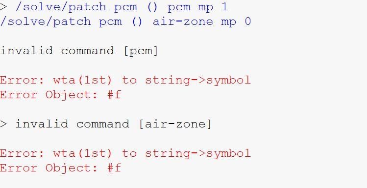

      Do you need the brackets around the pcm-zone? Always test a journal one line at a time before running remotely, if needs be use a smaller test case that has the same model set up as the real one. I'd also check the first line, I suspect it's also a problem.
    • Onyedika Mbelu
      Yes, I tested it on the TUI before running remotely. I got the errors attached. I have also tried different brackets too.

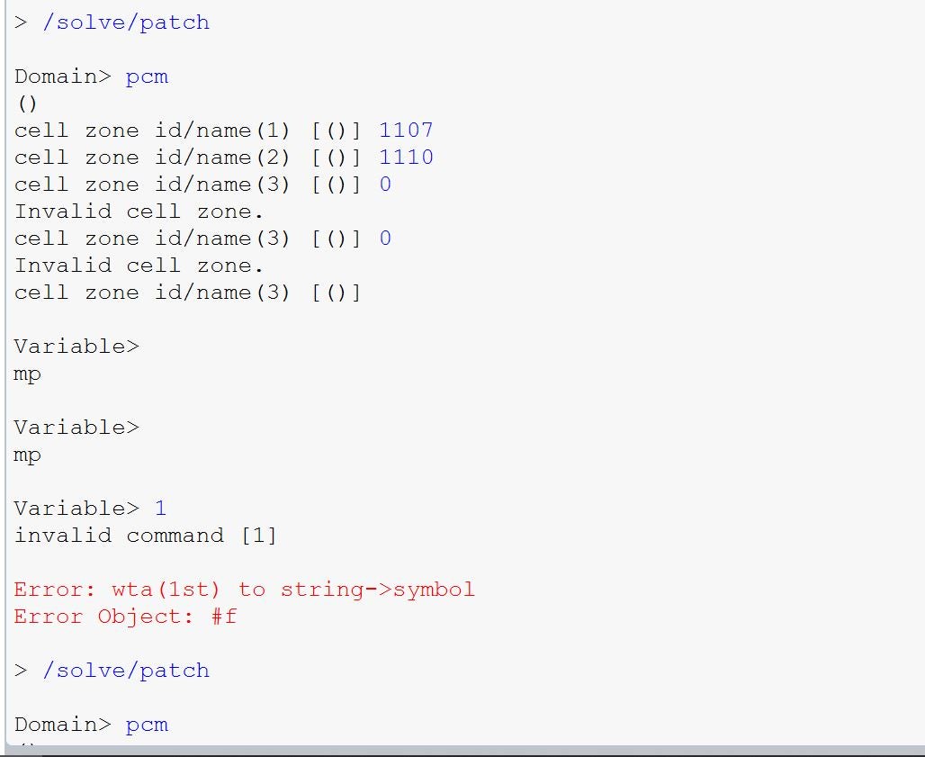

      OK, so type in
      /solve/patch
      and see what the solver prompts. The () option closes the list.
    • Onyedika Mbelu
      I don't quite understand your reply. I typed that in and I got the result shown above.
      OK, and how does that compare to your journal? Use () to finish the list selection, so 1107 () will choose to patch into zone 1107 only.
    • Onyedika Mbelu
      Thank you, it worked.
