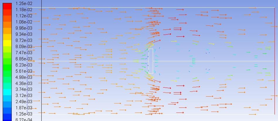

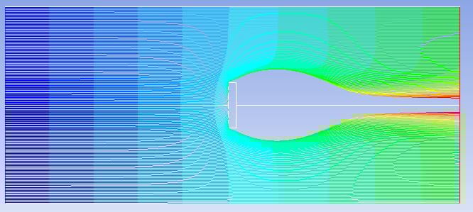

      Can you check the do you get any recirculation close to the wall. I guess the recirculation bubble will affect the flow and trapped particles. You can check the recirculation bubbles for both the velocities. It gives you more information on particle trapped. You can plot the streamlines and check.

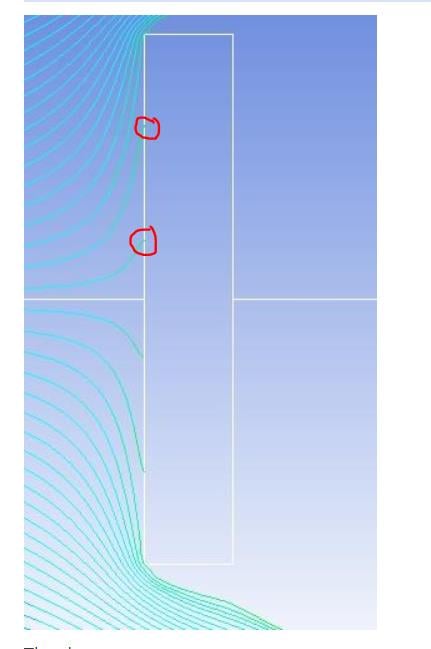

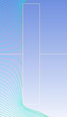

      Thank you so much for your help. There are some circulations under the plate, which is an area I am not interested in. Could this affect the flow above the plate? it is axisymmetry. Here are vector plots, streamlines, and particle tracking contour:
      closer to the plate:
      finally the particle tracking:

      If you could see the last picture which is closer look of particle tracks, we can easily tell that how many particles are trapped. I could see only two particle traces which hit the wall and trapped, rest of the traces are just flowing along the plate.
      As Karthik mentioned, one thing would be the mesh. I hope you would have the good mesh near the plate. Can you refine the mesh near the plate and check how many particles are trapped. I could not see any recirculation near the plate so number of particles trapped are less. Check the recirculation zone with low velocity case as well.
      Seeta
