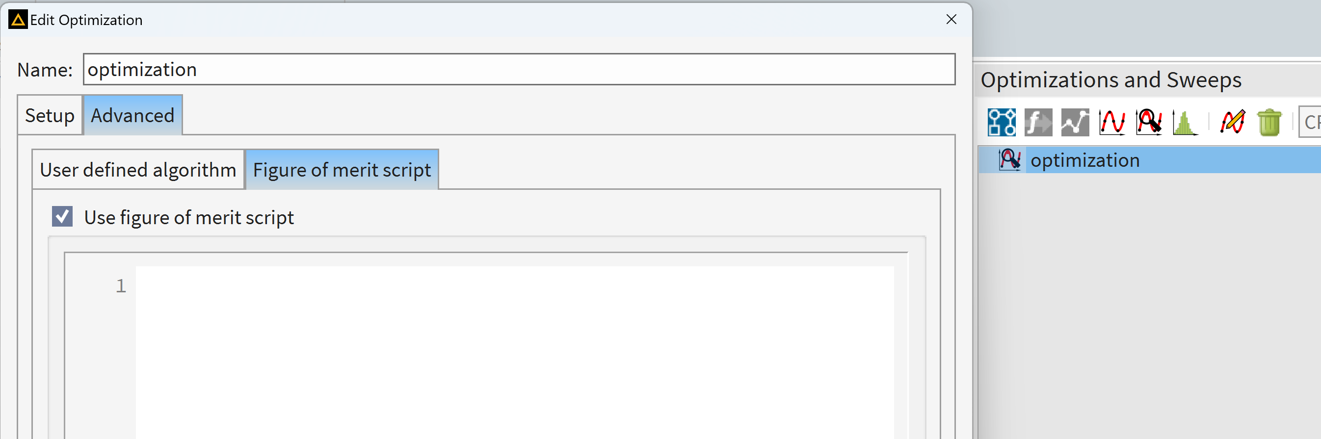

      Typically when using the particle swarm optimizer in FDTD, I can define custom figures of merit in the analysis script of the top level "model" object. In the Multiphysics package, there doesn't seem to be an analysis tab or script. This prevents me from defining custom metrics to use in the particle swarm optimizer. Is there another way to define custom figures of merrit to be optimized in the optimization utility?
    • George Patsamanis
      Hello, thank you for contacting us.
      You can define your custom FoM at the Figure of merit script tab from the Advanced settings of the optimization.
      Optimization utility – Ansys Optics
