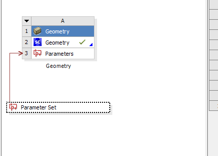

Is it possible to import excel or csv file to use it as Parameters study?
Or with Python if it is possible?

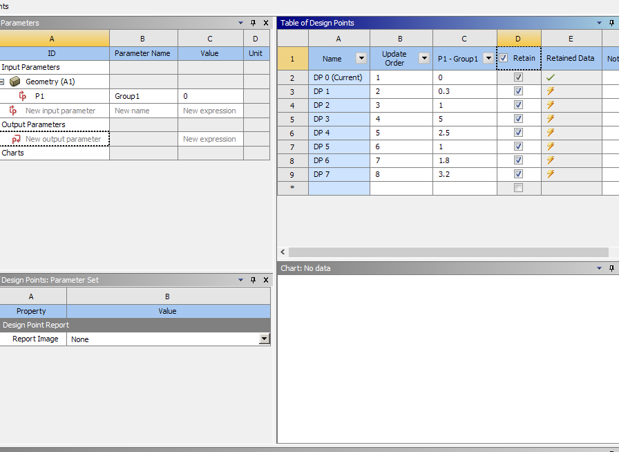

SubscriberCopy from Excel, Paste into Parameter Table of Design Points.
October 17, 2021 at 5:00 pmOctober 18, 2021 at 12:28 ampeteroznewman
SubscriberOpen the Project in Workbench.
October 18, 2021 at 12:55 amseghierdesign
SubscriberThanks peteroznewman
I did that but i don't know how to update and update parameters study values in discovery live.
Can you please show me a simple example or a clear tutorial avaialble ?

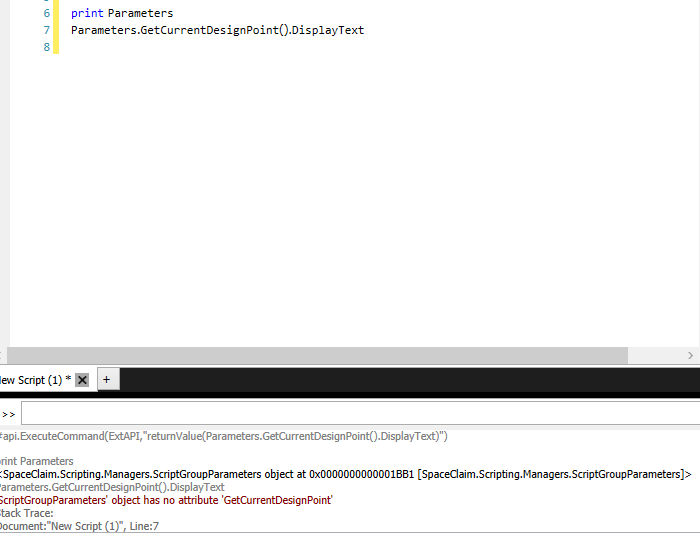

Sadly the video don't help, workbench update the geometry and create different files but don't update the list of values in discovery live
I hope they add an option to import excel file or at least allow modification via python.
I tried this without success

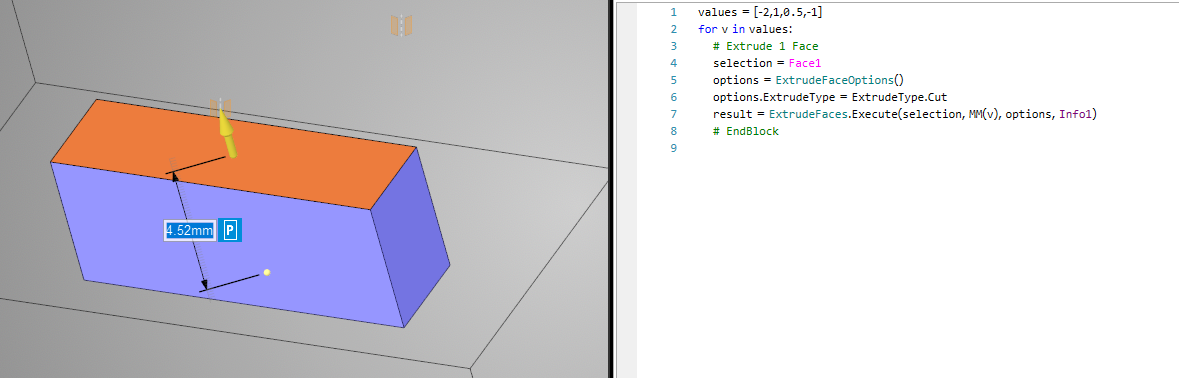

SubscriberI find a solution, maybe someone need it , using Group.TryGetDimensionValue
and this can used from external Python editor with other settings from Unsupported.Live
