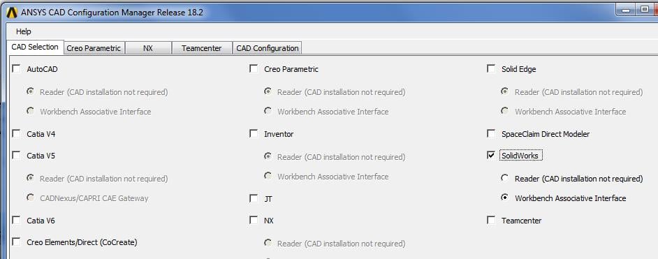

      If this isn't working for you, then you may not have run the CAD Configuration tool during installation. You can do that now. Start, ANSYS 18.2, Utilities, CAD Configuration Manager 18.2.   Click the Solidworks and push the Workbench Associative Interface radio button, then Next.
      Then click the Configure Selected CAD Interfaces button. The text in the window indicating Success will appear. Exit.

      Yes, I think a crucial step missed in all of the tutorials was the CAD Configuration Tool. Once I run this, everything worked.
      Thank you very much.
