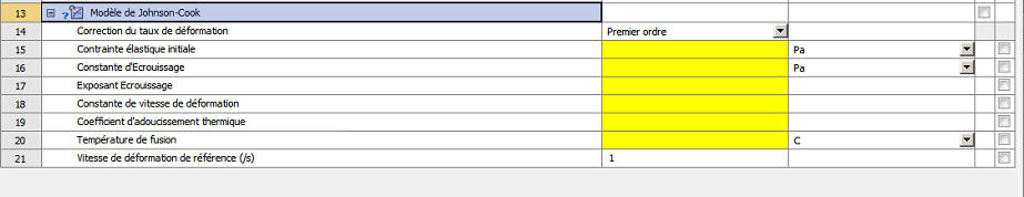

SubscriberHello. Friends I have a problem. I have a strain/stress graph. Now I need to find the deformation parameters for Johnson-Cook (A, B, C, n, m). There are no tutorials on how to do this. There are a few videos on youtube but it's not clear. Could you tell me how to do it consistently? The points. Do you have an excel spreadsheet?

SubscriberThanks for the answer, but it doesn't work for me. I tested steel on the stand. I have a graph, I made a strenght and stress curve from this graph. Now, using these data, I need to find data for the Johnson-Cook deformation. Like here: https://www.youtube.com/watch?v=vRTgY1HikUQ&pp=ugMICgJydRABGAE%3D But this video is not clear. I would like a more detailed description of how to do this. Or maybe there is a ready-made Excel table where you could drive in the chart parameters and get Johnson-cook data

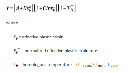

In terms of temperature, T is the current temperature calculated from the local plastic work done, T0 is the initial reference temperature (stress-free), and Tp is the temperature for melting. When the deformed material has done a lot of plastic work, it will increase the temperature in the heavily deformed material. The increase of the temperature will further reduce the yield stress of the material. This is also called as "thermal softening".

April 20, 2022 at 6:29 pmChris Quan
Ansys EmployeeYes, it is true that T_H is equal to zero due to T = T_0 at the beginning of the simulation.
Thus, the third term of the Johnson-Cook model is equal to 1, which means no thermal softening at this temperature. See attached picture below.
Thermal softening starts when the temperature in an element is elevated and has exceeded the initial temperature.
