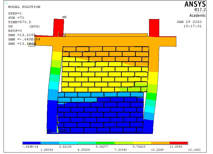

      I am modeling a wall in ANSYS APDL in which sliding occurs as soon as I apply the displacement as I am doing displacement control analysis. I am using friction model to define interface property.
      But In Friction model, which parameter is used to control the stiffness before sliding??

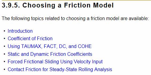

      I'm not sure what you mean by "stiffness". You can read more about friction in the ANSYS Help.

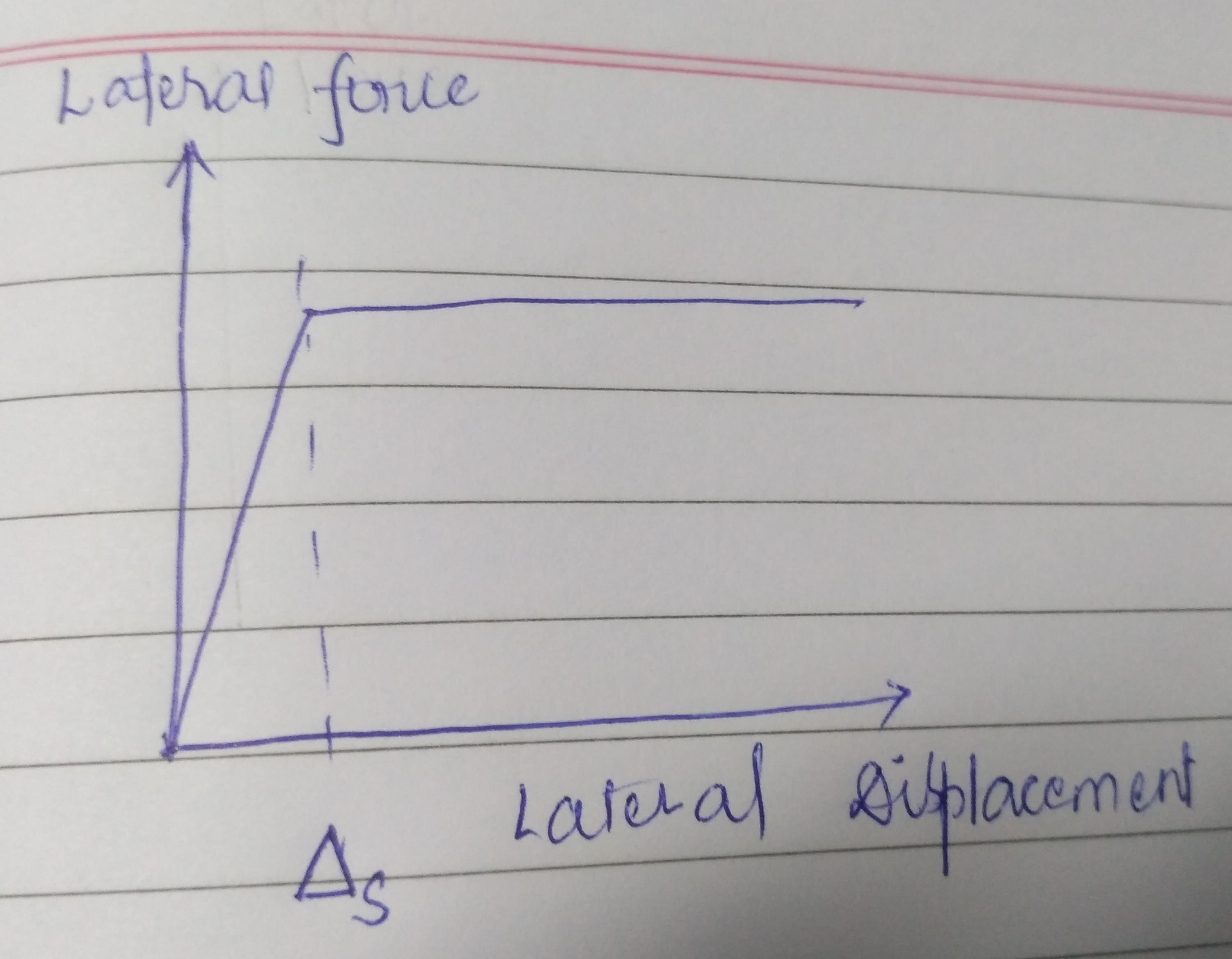

      I have read the topics but in the figure 2 attached, if delta s is the displacement at which sliding starts in the model then stiffness of force-displacement curve before delta s can be controlled by which parameter??
      Because in my model as soon as I apply the lateral displacement, the layer defined by friction model and no separation sliding permitted contact starts sliding, which does not happen in usual friction case. As model should start sliding after some time i.e. after this delta s displacement.

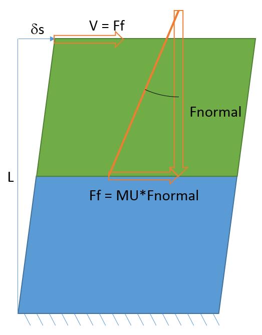

      The material property that defines the shear deformation that you labeled Delta sub s is the shear modulus G.
      If you have two blocks, as long as the shearing force V is < mu*Fnormal, the blocks will shear without the frictional interface sliding.

      But, in my model this is what is not happening, before any shear deformation the sliding (blocks displace relative to each other, can be seen from fig 1) occurs at the start of application of lateral displacement. I don't understand how to control these phenomenon.
      As I want my model to behave similar to what you have explained.
      Please help me with these as how to control the displacement of sliding layer before a certain value of lateral displacement.

      I have done hand calculation on the basis of live load+self-weight acting on the sliding layer, as per my calculation shear deformation is 3.3 mm but in my model relative displacement between the sliding layer start  from 0.1 mm onward, which shouldn't happen. And I want to understand why is it happening.
      Is it because of no separation contact behavior (keyopt (12) = 2) and friction model I applied to that interface. What phenomenon is happening over there, this I want to understand, so that I can able to explain about my model behavior.
