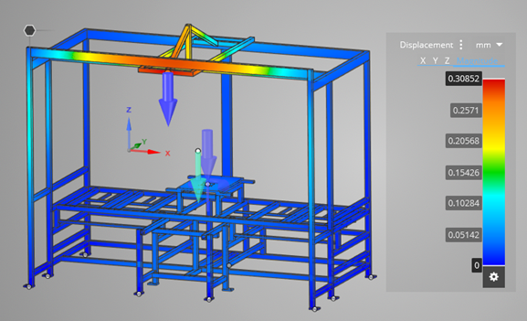

SubscriberHi, Â Can you possibly answer this. Did a specific load case sim on the same frame and I would like the scale to higher than what Discovery brings up. This is the results and the scale it shows by default. Â I would like to override the scale and have it show 0 to 1.0 rather than 0 to .30852 This way nothing on the image will be red which looks bad even though the number is very small. I would then use the different scale image for a customer report, which again would look better as it would not show red. Â I cannot seem to do this ? Â Is this possible ? Â Thanks, Ali

You can click on the first value on your contour (0.30852mm in your case) and make it 1 to get the desired contour. Please check and let me know if that is what you were trying to get.

SubscriberHi Charudatta Bandgar ,
I tried that way back and it didn't worked.

SubscriberSyed Saif Ali Hello, Apologies for the confusion, the contour can not pick a value greater than the maximum value the way you want. We thank you for sharing your feedback. We will share your idea/input with the product development team. Regards.
