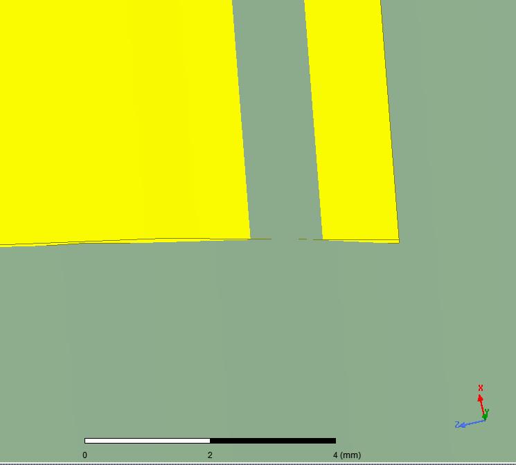

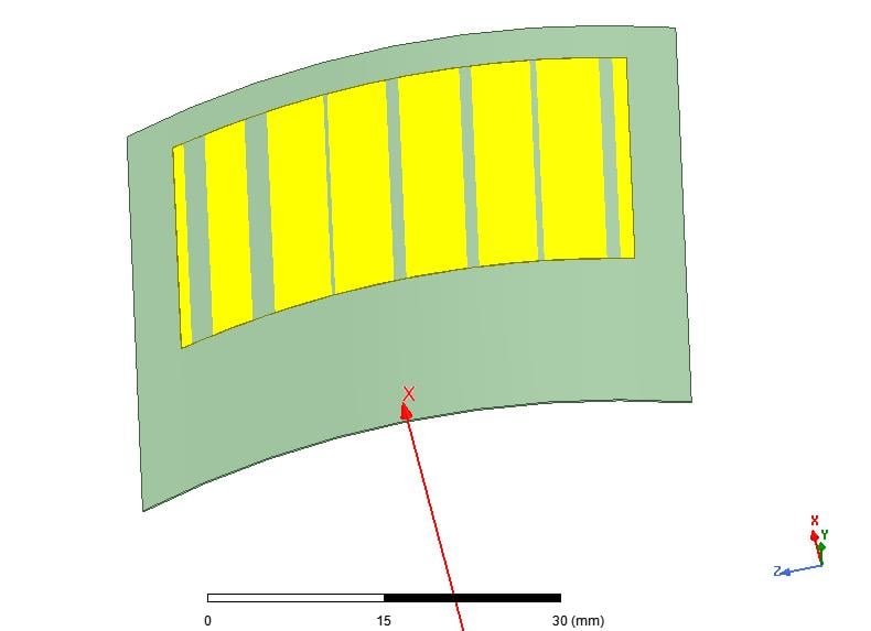

Ansys EmployeeThis may simply be due to visualization settings and will not affect simulation results.Â
View>>Render>>Curved Object Visualization
Decrease Max Normal Deviation from default 30deg down to 1 or 2deg.
The default setting of 30deg helps the graphics-related responsiveness of the 3D Modeler window.Â
Hope this resolves your issue!
January 16, 2020 at 9:03 am
Abdou1
Subscriberit works well thank you very mutch
but i am not agree with you that will not affect the simulation because it two different material are in interconnection ?.
