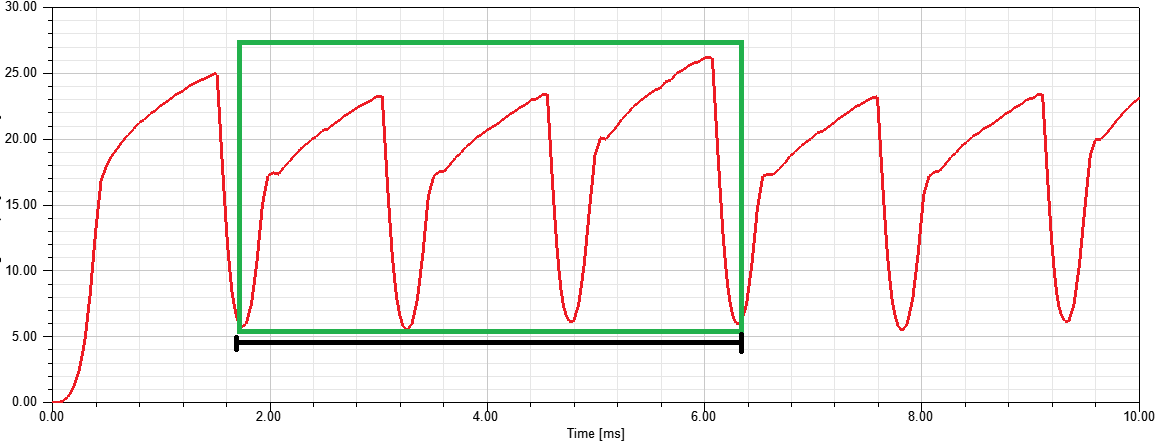

SubscriberHello,
Like you see in the figure below I have plotted the torque curve but I need to export the minimum value of the output variable in the range ex[1.5ms 6.8ms], I can create the torque report and use the function (min) with a specified range, but I need to use (GetOutputVariableValue) function to export the min value in the range (from 1.5ms to 6.8ms) to Matlab.
November 3, 2021 at 2:32 pmNKC
Forum ModeratorHi @M_reda You can not get that directly from maxwell.
You can extract the graph data into maxwell using "getoutputvariablevalue" command and then process the data in maxwell.
Regards Navya
