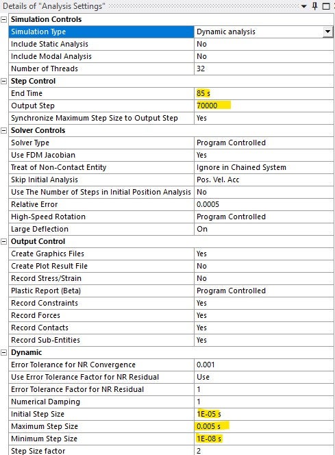

SubscriberI’m encountering an issue in my Ansys Motion analysis related to the Output Step setting. When I set
Output Step = 60000
, I receive an error indicating that the software cannot reduce the timestep further. However, when I increase the value toOutput Step = 75000
, the error disappears.I’ve reviewed the User Guide (attached), but I find the explanation a bit confusing. Since output steps are primarily for post-processing, I’m wondering why they seem to affect the simulation itself. My understanding is that Ansys determines timesteps based on the minimum and maximum step sizes defined in the solver settings—so why would the output step interfere?
Additionally, even with this relatively large number of output steps, the time increment in the animation during post-processing appears to be 1 second. Is this expected behavior, or is there a way to adjust it?
I would greatly appreciate any insights or advice from the community regarding this issue.

Ansys EmployeeHi,
The number of output steps also controls the solution time step size when the synchronize option is set to yes. The effect of it is shown in the documentation. Please try to run it without the synchronize option if you don't want your solution step size time to be affected by it.
In the tabular data, check how many points are generated for the results. You can animate the results over those many data points.
