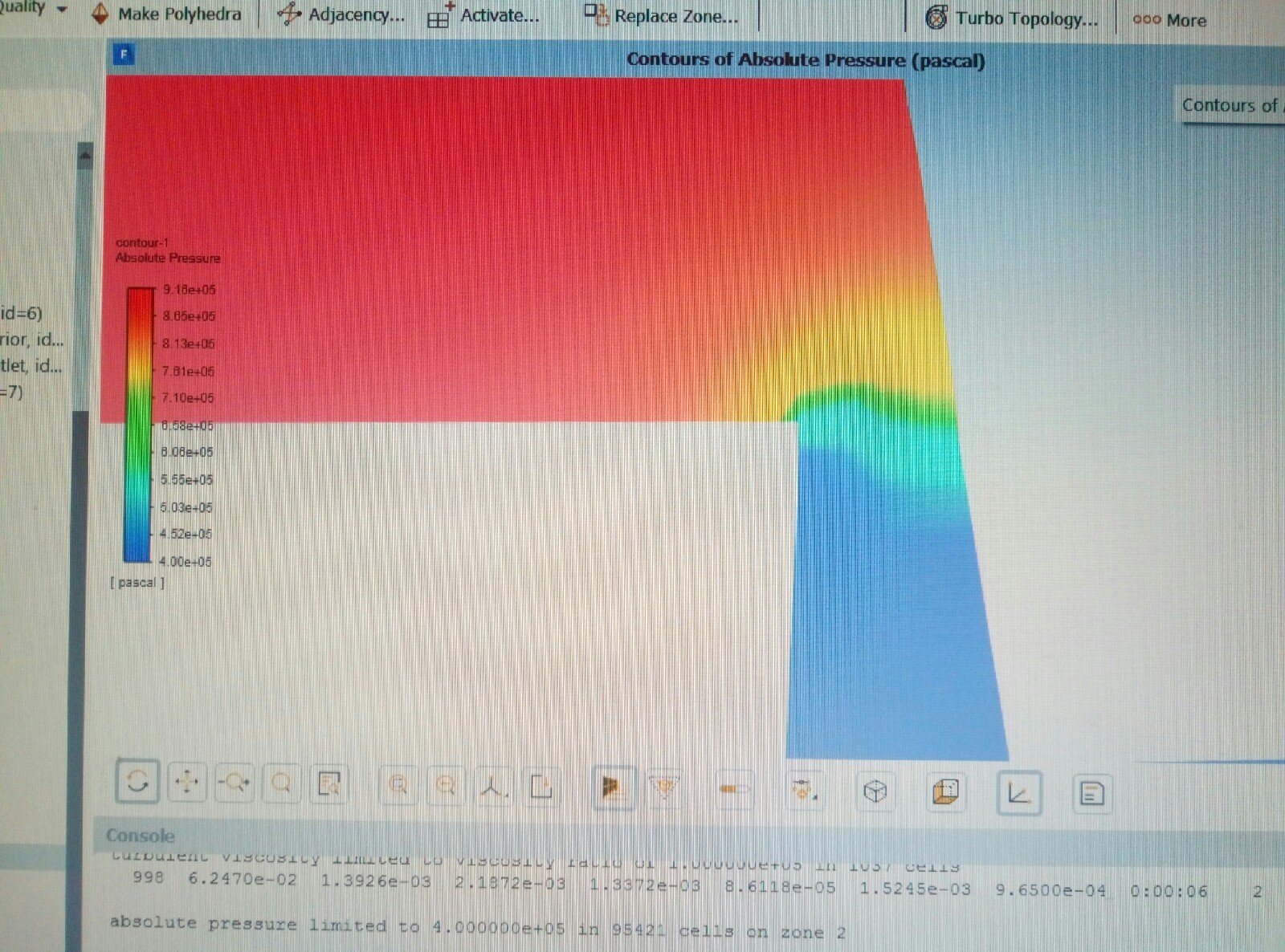

      Hello everyone, I have problem with droped pressure at outlet boundary zoneYou may see, that absolute pressure has value 400 000 Pa

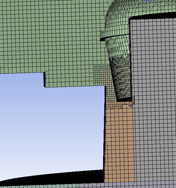

      I have the body (Fig 1) with sharp narrowing of the middle part (Fig 2).

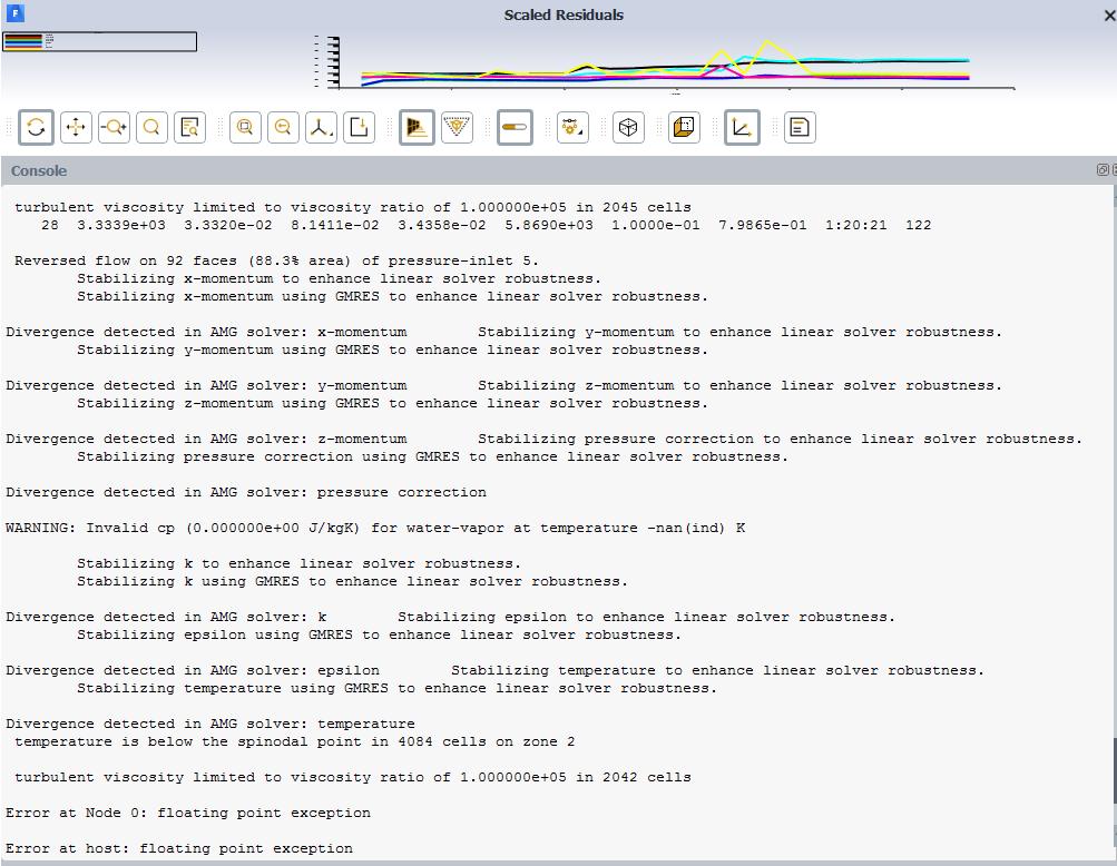

      In Solution Controls Under-Relaxation Factors for Momentum, Turbulent Kinetic Energy, Energy set 0.1, as there were problems with the error "Divergence detected in AMG solver: pressure correction" and "Divergence detected in AMG solver temperature". These settings helped solve the problems.

      My problem is the pressure in the output region drops to values lower boundary pressure, which is set in the Solution Controls Limits, default is 1 Pa, and the result is 1 Pa, I increase the lower boundary Solution Controls Limits for pressure to 100 000 Pa, in result I have 100 000 Pa, I increase the lower boundary to 400 000 Pa, in result I have 400 000 Pa, the real result should be around 550 000 Pa. I used different versions of the grid such as Tetra, Hexa (CutCell), broke into separate parts of the body and created for each of its own, used a different size for grid’s elements, the result is the same, I was getting lower pressure limit from Solution Controls Limits .Does anyone know how to solve this? Thanks.

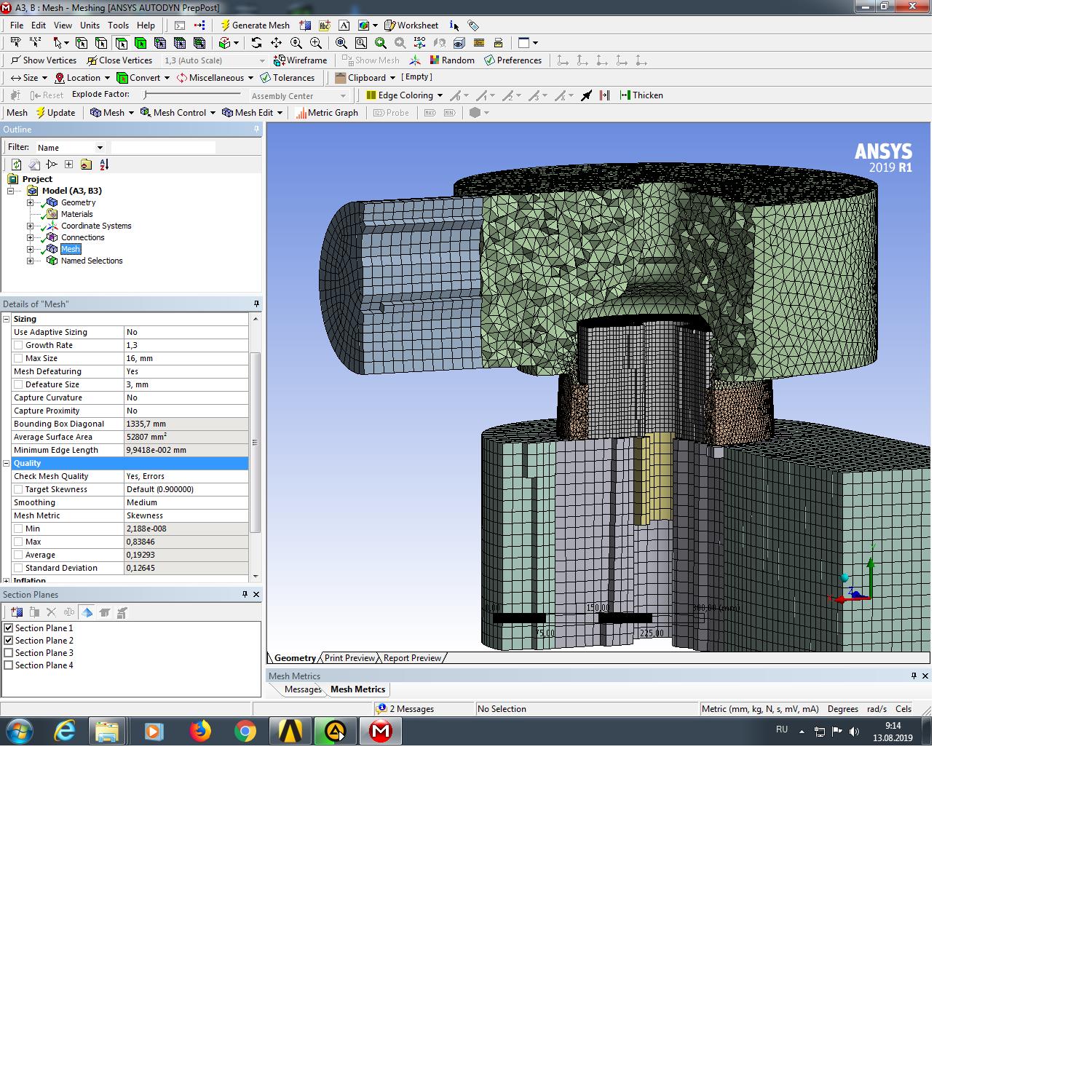

      I used many different type of mesh. Last used mesh had this characteristic

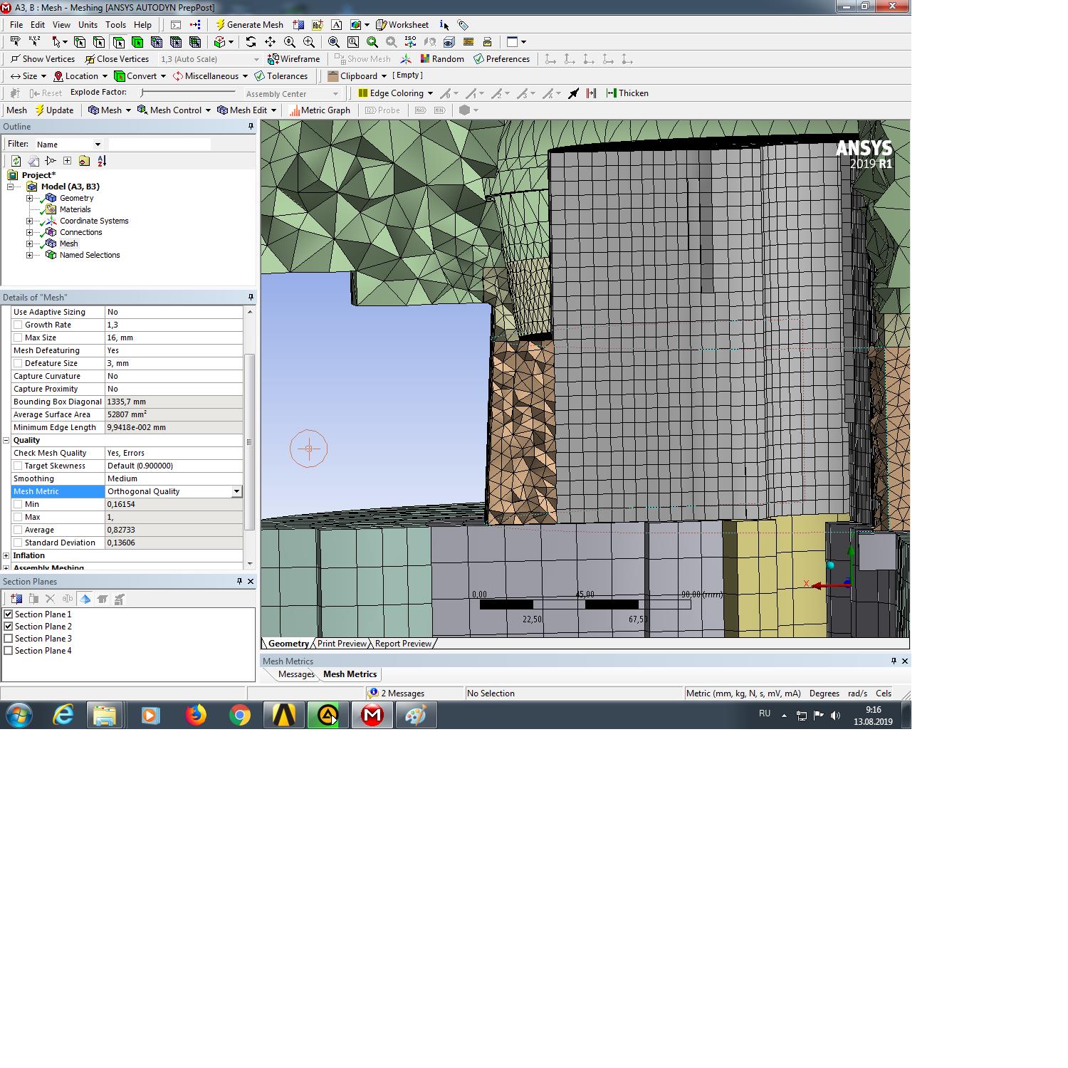

      I suspect you need a lot more mesh in that region: I think there are only 2-3 cells across the gap? You've also got several discontinuities in the mesh suggesting you're using mesh interfaces: that's not ideal and combined with a large jump in cell size won't help convergence or accuracy.

      Thanks for answer, yeah, in this case used ~3 cells, early i used cutcell mesh with 9 cells. "You've also got several discontinuities in the mesh suggesting you're using mesh interfaces" - how may i fix it?

      Use a share topology operation (SpaceClaim) or multibody part (DesignModeler).  Mesh quality is a lot more than just getting good cells: there's resolution & growth rate to consider too.

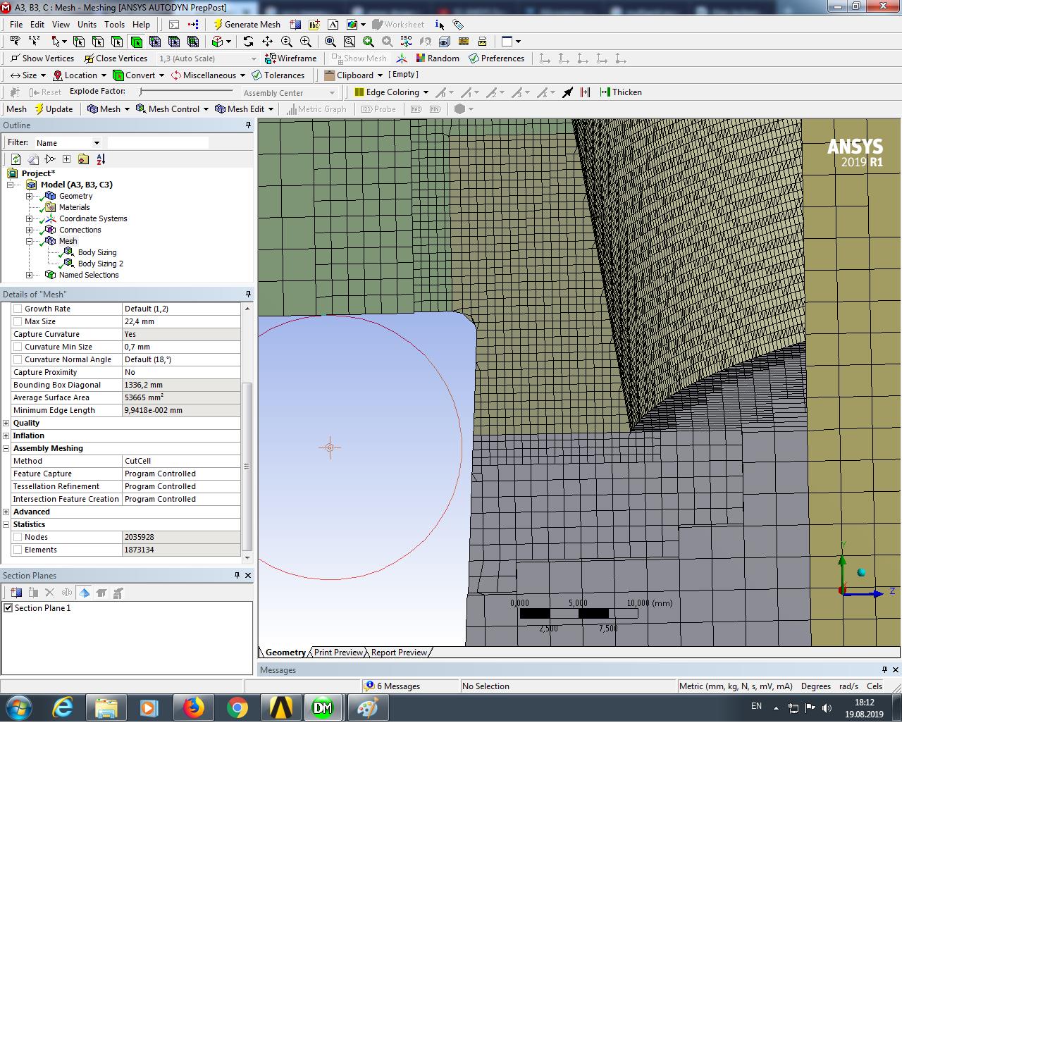

      Unfortantli I dont find this "multibody part (DesignModeler)", may I use Share Topology in DesignModeler for it? And for now I use CutCell mesh in my problem, but it dont solve my trouble with dropped pressure.Thank you for you attention.
      I get kind of this

      Multibody part is when you put all bodies into a single part and the mesh will be then conformal.
      Check mesh quality again.
