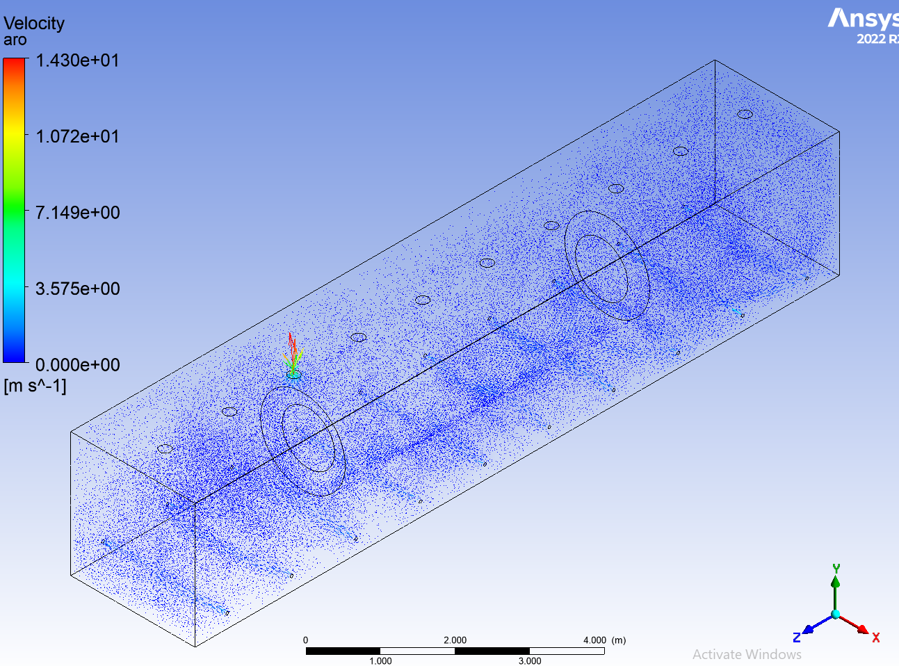

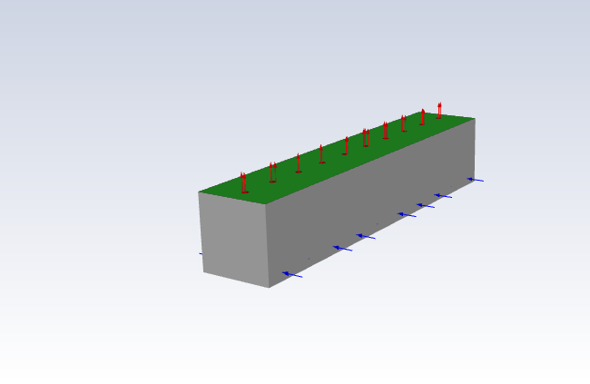

      Here I have attached the initial mesh with the indicators showing where I would expect the inlet and outlet flow to go, however, after completing my transient run and examining the velocity profiles I found that only one of the outlets was actually being utilized as seen here:
      I didn't think there was any issue with my setup??

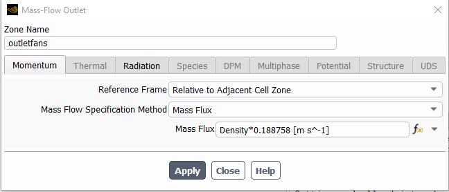

    • Murari Iyengar
      What Boundary Condition have you set for the outlets?
    • Murari Iyengar
      If you are using Mass-flow-outlet, look at 7.4. Boundary Conditions (ansys.com) on how to define it.
    • T-Ying Lin
      Here are my initial settings
