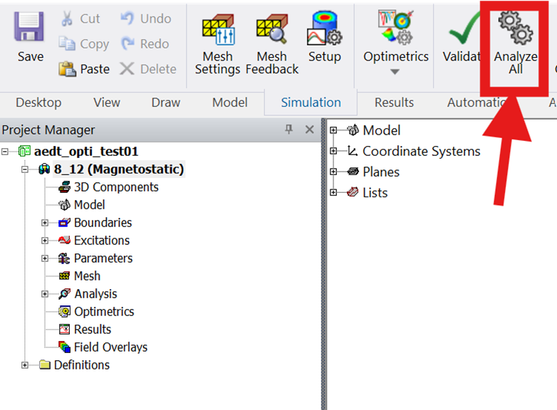

      In AEDT, I setup a simple 3D Magnetostatic project and analyzed it:

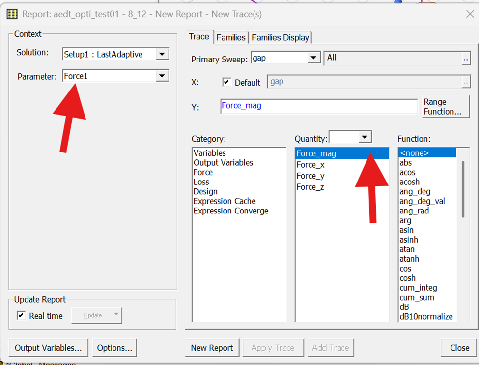

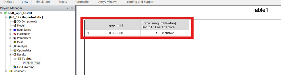

      Then in the Project Manager, I right-click on Results -> Create Magnetostatic Report -> Data Table to see the results of the simulation:

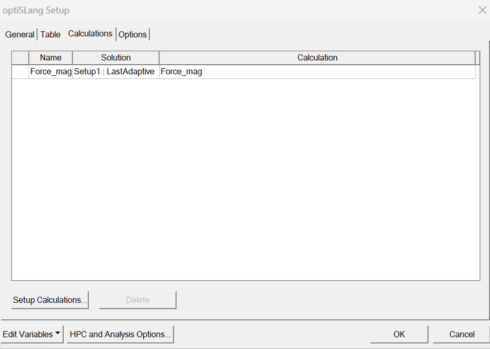

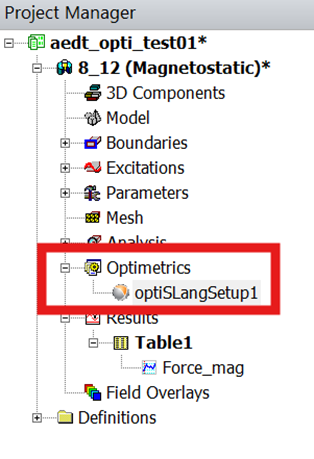

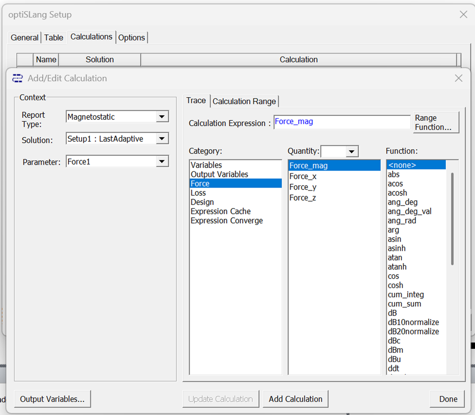

      After saving the project, in Project Maneger, I right-click on Optimetrics and added an “optiSLang Setup“. In the optiSLang Setup I added a calculation:
      Back in Project Manager, I right-clicked optiSLangSetup1 and selected Create optiSLang Project:

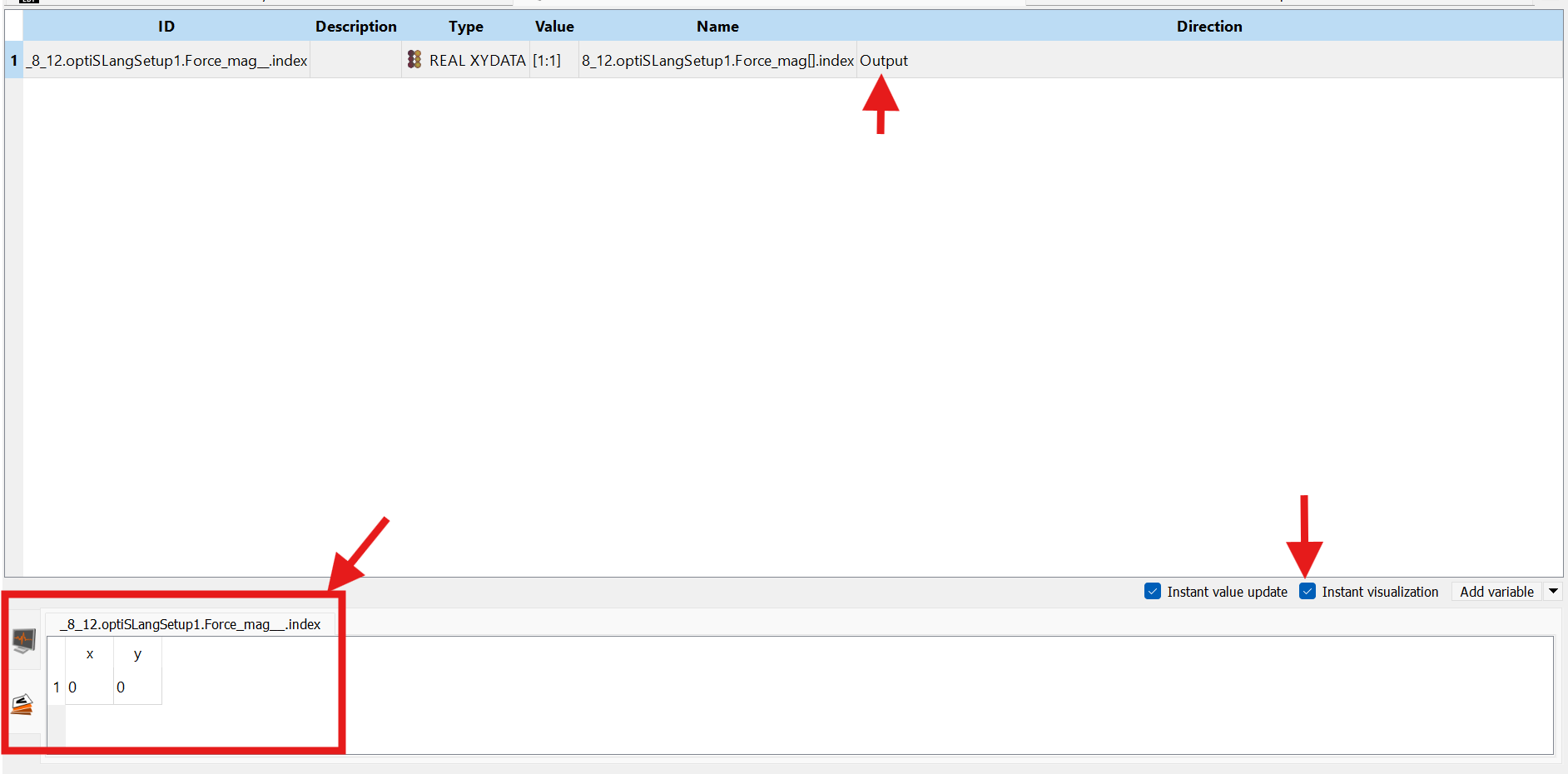

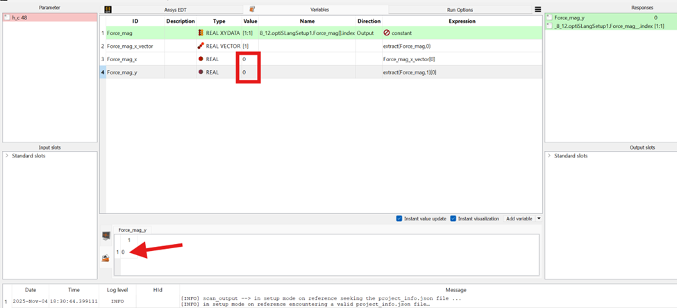

      Once optiSLang window opened I noticed that the output was added automatically. I navigated to the Variables tab and clicked on Instant Visulaztion to verify the values of the response:

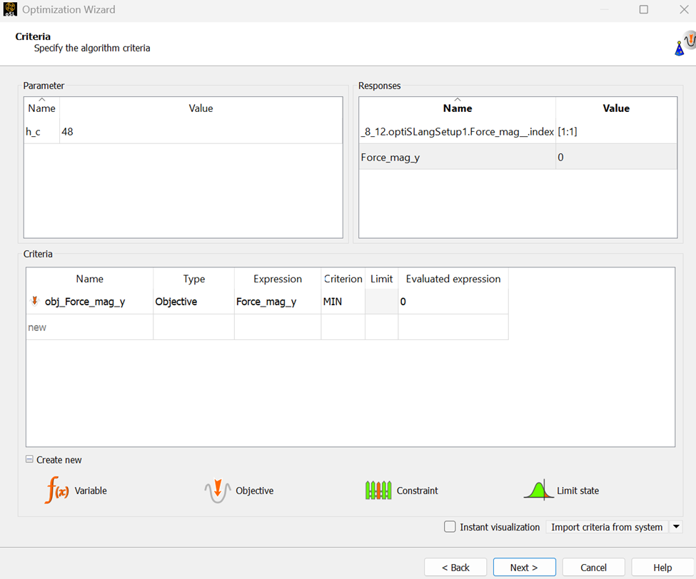

      My question is that why the values of x and y vectors are 0? Please advise if I missed a critical step. I expected these values to match the ones from the Maxell Report (Table1).
      My goal is to extract a scalar force magnitude (1 value) and use it in the optimization objective. As seen from the Maxwell results, this scalar value is 0.103N.

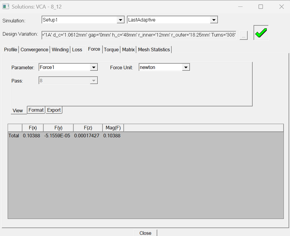

      • abasirat
        Please see the screenshot below from Maxwell simulation solution. Force1 parameter has x, y, and z components:
