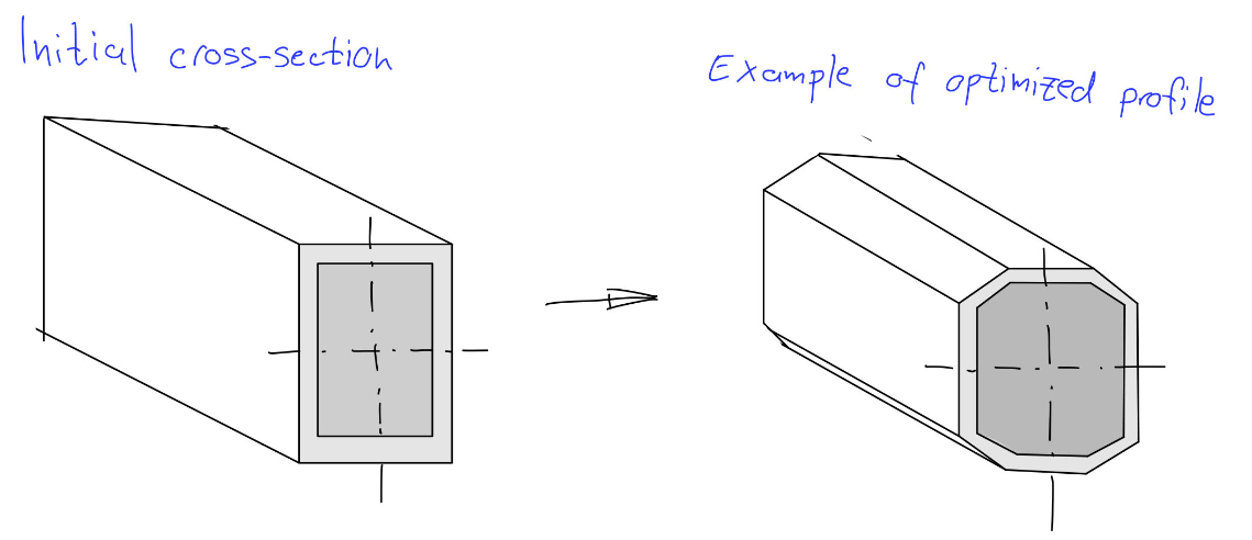

      Hello. Is it possible in ANSYS with topology optimization optimize the profile cross-section of a beam? I am attaching an example.

      I tried optimizing the profile, but with the topology optimization the program removes material from areas. I want to optimize the shape of the cross-section, as I showed in the example above. Is there another method for this type of optimization or do I need to define additional requirements?
    • joseronaldo.15
      Search for information on topographic optimization, it’s the closest thing to the idea you’re expressing.
