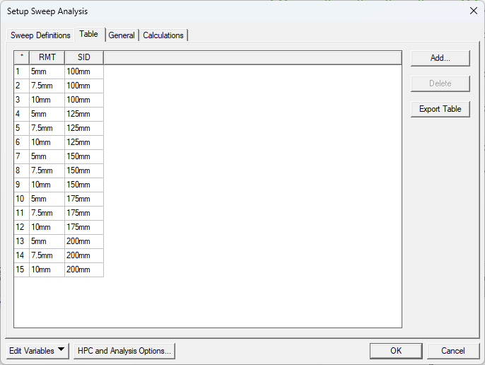

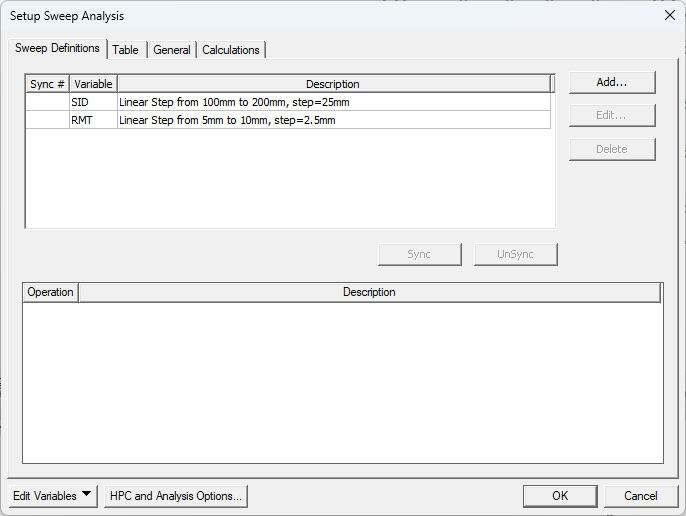

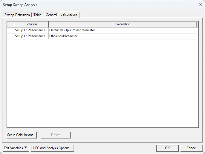

I wanted to send this post regarding an issue I'm having with optimetrics trying to run a AFPM parametric analysis through a variation of parameters i.e. magnet thickness and rotor length, and inner diameters. The condition and named parameters are given below:
SOD: Rotor/Stator outer diameter set fixed at 250mm
SID: Stator/Rotor inner diameter set at varying parameters starting from 100mm-200mm in 25mm increments
RMT: Rotor length/ Magnet Thickness both changing synchrnously with varying values of 5mm-10mm in 2.5mm increments
Below is an image of the values input into optimetrics:

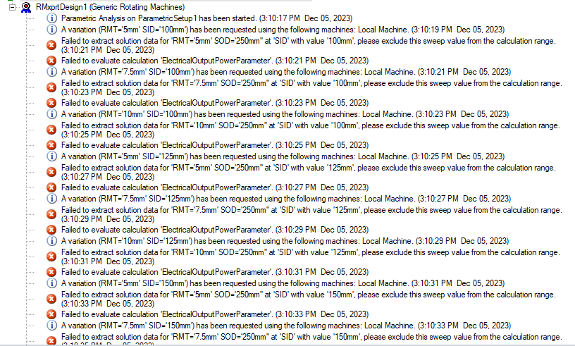

 The issue is when I try to run this parametric analysis, I'm presented with the following error:
For this reason, would it please possible to get help on this issue. Please let me know if additional information is neccesary. Thanks

Ansys EmployeeHello,
Please right click Results and clean up all solution data before start running the analysis.
