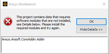

Subscriber@OROI has provided an archive with a Transient Structural model with an imported load in this discussion: /forum/discussion/33919/transient-structural-analysis-busbar-vibration
When I try to open that archive in Ansys Workbench 2021 R2, I get the following error:
November 29, 2021 at 6:06 pmGeorge Karnos
Ansys EmployeeInstalling Electronics Suite and registering it with Workbench should allow you to continue.
November 29, 2021 at 6:50 pmpeteroznewman
SubscriberThank you for the answer. Would that work if I installed Maxwell 3D even if I don't have a license?
I expect it doesn't come up often but when models are shared between people with different licenses, it would be better if Workbench would open and allow access to the analysis blocks that are licensed on the receiving computer and show an error only on the analysis blocks that are not licensed.
The problem was resolved by Exporting just the Transient Structural analysis, leaving behind the Maxwell 3D analysis.
