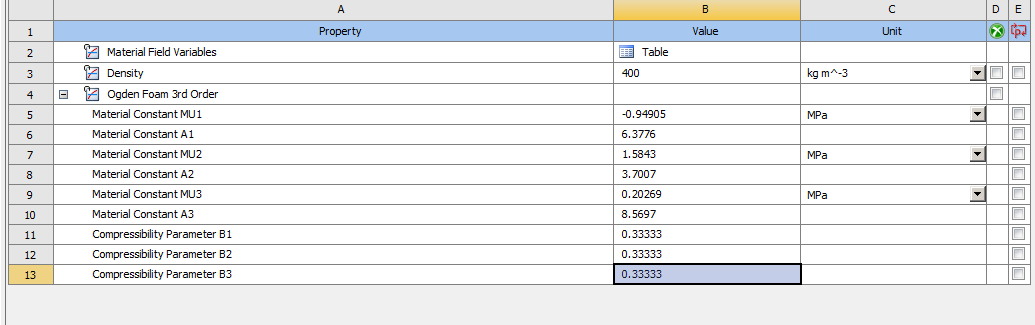

Anyone have an idea why the Ogden foam model 3rd order is not working in explicit.

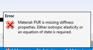

Ansys EmployeeThe answer is in your query, You need to define some form of elasticity of your material, either the elastic terms or the EOS terms with density. Try researching about such material such as Poisson's ratio, Density and Youngs Modulo to start with and then build an basic model. For further help, try to give Material name or class so that better suggestions can be made.

I am modeling polyurethane foam. I got the uniaxial compression data from a lab test I have done. I did curve fitting outside Ansys because the Ogden-foam model doesn't have curve fitting for some reason, and I got these constants.
I have also defined the foam density, shouldn't that be enough? If I put Young's modulus (linear elasticity) the hyperelastic model will be turned off of course. I don't know why the model is not working like other ones (Mooney-Rivlin, Neo-Hooken, Yeoh .....).

SubscriberDear,sorry to bother you but can you or any active support member look at this problem? I feel I am doing everything right but explicit still asks me for defining elasticity which should be defined already by the model.

SubscriberIf you were using Transient Dynamics instead of Explicit Dynamics, then it would be enough. Why are you using Explicit Dynamics?
Explicit Dynamics is not an APDL solver so not all materials that work with APDL work in Explicit Dynamics.
Do as said and define an EOS for this material if you insist on using Explicit Dynamics.

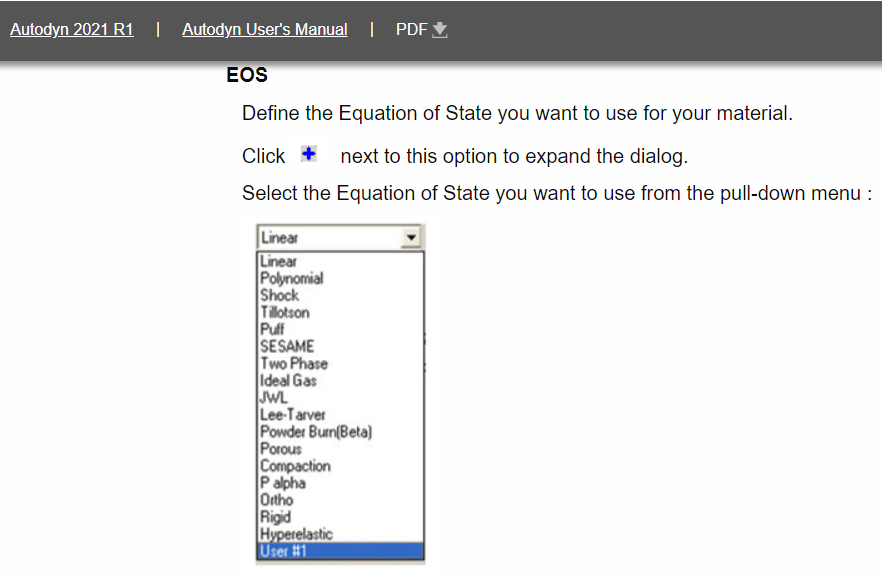

Explicit Dynamics uses the Autodyn solver. Below is the help section for that. Note that Hyperelastic is one of the choices on the pull down menu.

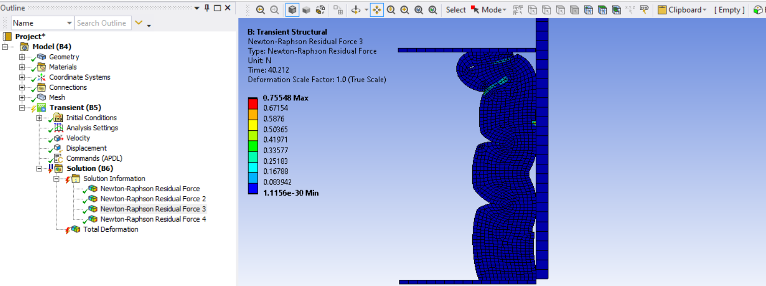

SubscriberDear Thank you very much for your help. I am using explict to run the same type of simulation you helped me with before and it had problems with the convergence for self contact elements after trying everything so we moved it to explicit. Can transient dynamics handle self contact as well?
Another thing, could you tell me from were you obtained the web manual you showed above, I could not find it anywhere.

SubscriberYes, transient dynamics can do self contact, but it must be manually created. The implicit solver has to do more work to find equilibrium with contact than the explicit solver.
Open ANSYS Help using the Start Menu, ANSYS, ANSYS Help. Along the bottom is a set of alphabetical categories. Click on the AQ-CO category, then click on the Autodyn button.

Thank you so much again. Still, the same issue with self contact even though I defined it and tried most of the convergence tips I know.
Does it seem like there is no way for this simulation to work without explicit? I am not sure if more can be done but I guess I have to define EOS in explicit as you said.
May 2, 2021 at 6:49 pmpeteroznewman
SubscriberYes I agree that Explicit Dynamics is better for this problem.
