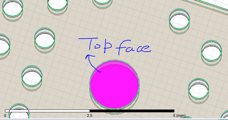

      2. How do I ensure that the exported design for Q3D analysis has hollow vias? Under export options, this setting is unchecked "100% via fill (overrides per-padstack plating ratio)". Just to give more context, I can only choose top and bottom faces of the vias within Electromangnetic suite while assigning excitation. If hollow vias are available, then I might be able to choose the inner cylinder of the via. How can I validate whether a hollow or filled via is exported using Q3D extractor option?

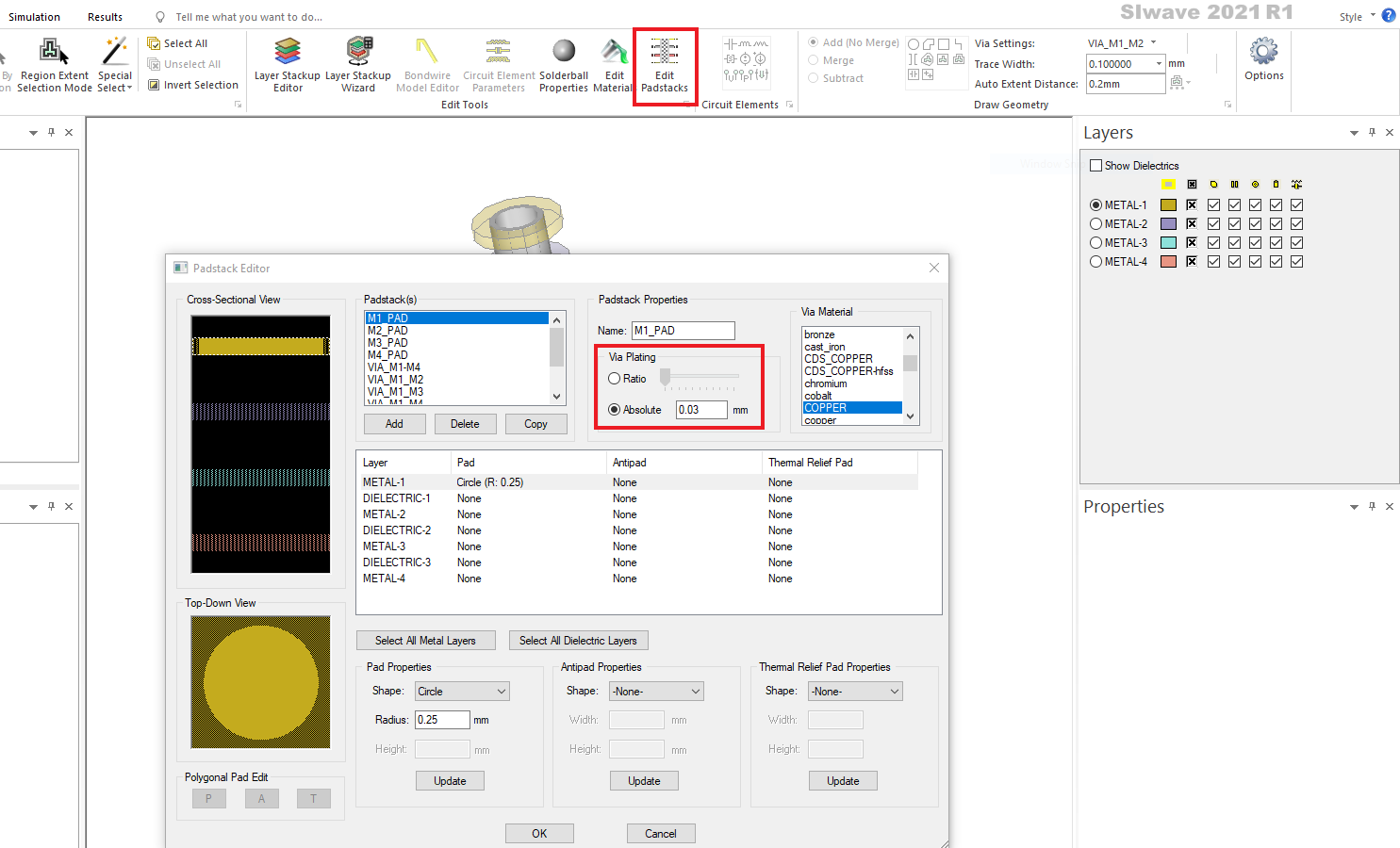

      Hi Array ,
      If you are asking how you can "validate" whether hollow or filled vias are exported to Q3D, to me, the obvious solution would be to open up Q3D after export and look at the vias. Also, the padstacks could be examined first in SIwave before exporting to Q3D to make sure the via plating is not 100%.

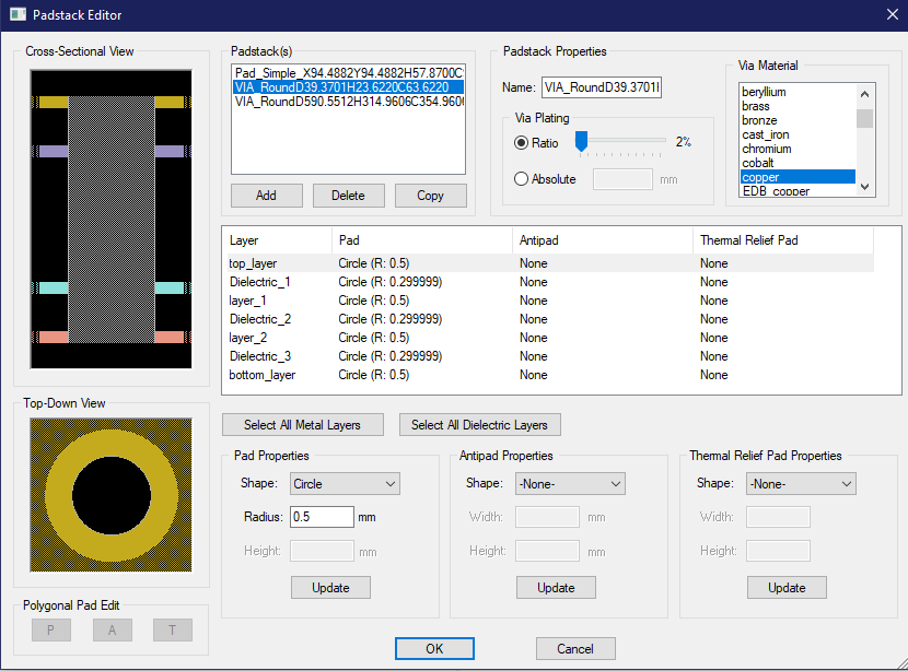

    • Jackson
      Via thickness can be checked in SIwave prior to export. You can edit it too if it is not the thickness you want.

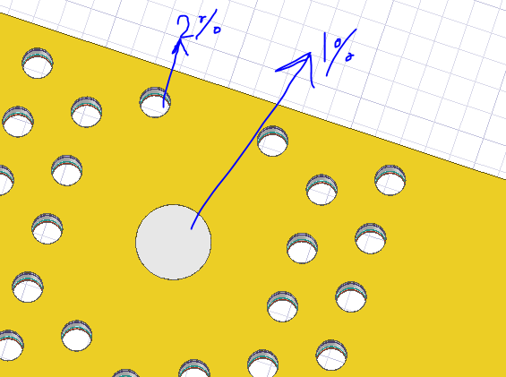

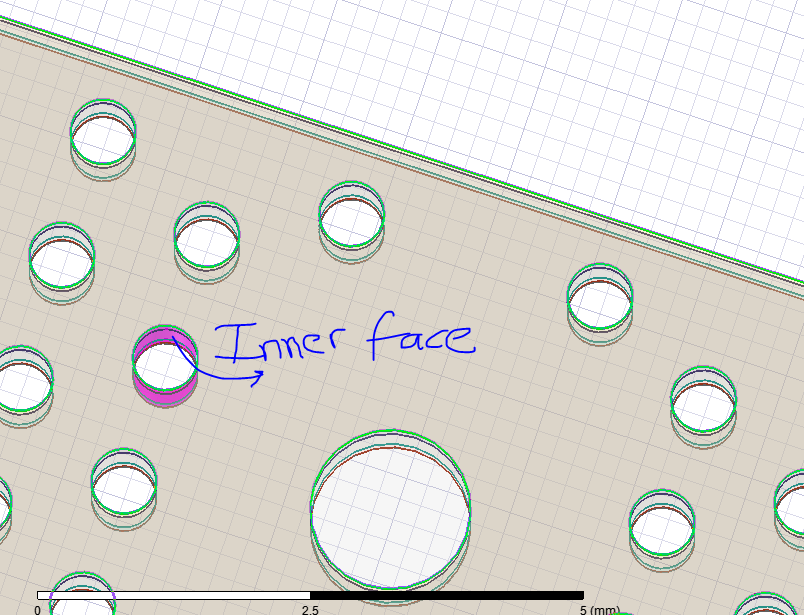

      Jackson Thanks for the pictures, which helps a lot. I am noticing that Via Plating ratio has to be atleast 2% in order to properly see hollow vias in Q3D. I have tried 1% ratio, then once again I am unable to see hollow vias. I am attaching screenshot of the Q3D and SiWave workspaces.
      If the vias are not hollow (the case with 1% plating in SiWave), then I am unable to select the inner face/ring of a the via within Q3D. In this case I can only select top and bottom faces, which in reality should be empty. In the second case with 2% plating, I can select the inner face. See attached images.
