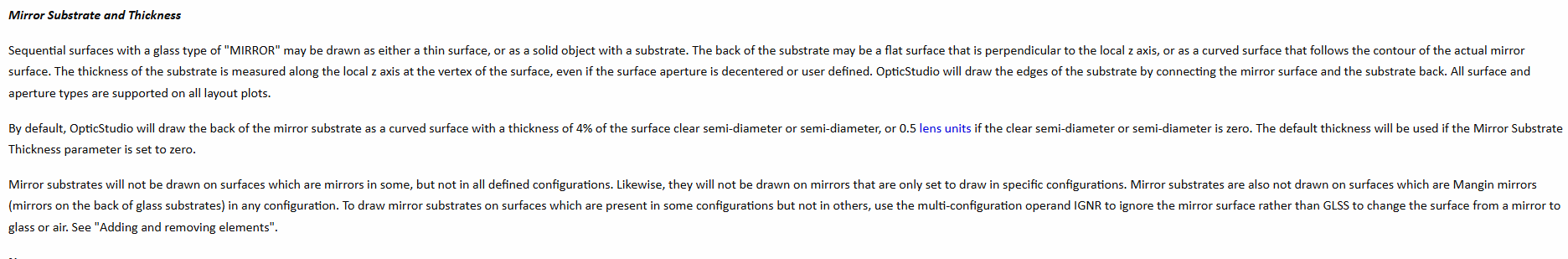

SubscriberI am using OAPs in my current design. Can Zemax draw an OAP with uniform edge thickness and a flat back surface? I would like to create OAPs with edges that are perpendicular to the back surface and close to uniform thickness all the way around the periphery. I only see a standard wedge shape and 'curve' shape available. Please advise.
August 6, 2025 at 7:32 am
Niki Papachristou
Forum ModeratorHi Oderney,
Thank you for reaching out to us! May I ask you if you have explored the Draw surface properties option within your designs? I think that this mighrt be a good solution for you: Draw (surface properties), it also includes the "Flat To Next Surface" option as well.
Let me know if that helped you or you need further assistance.
Kind Regards,

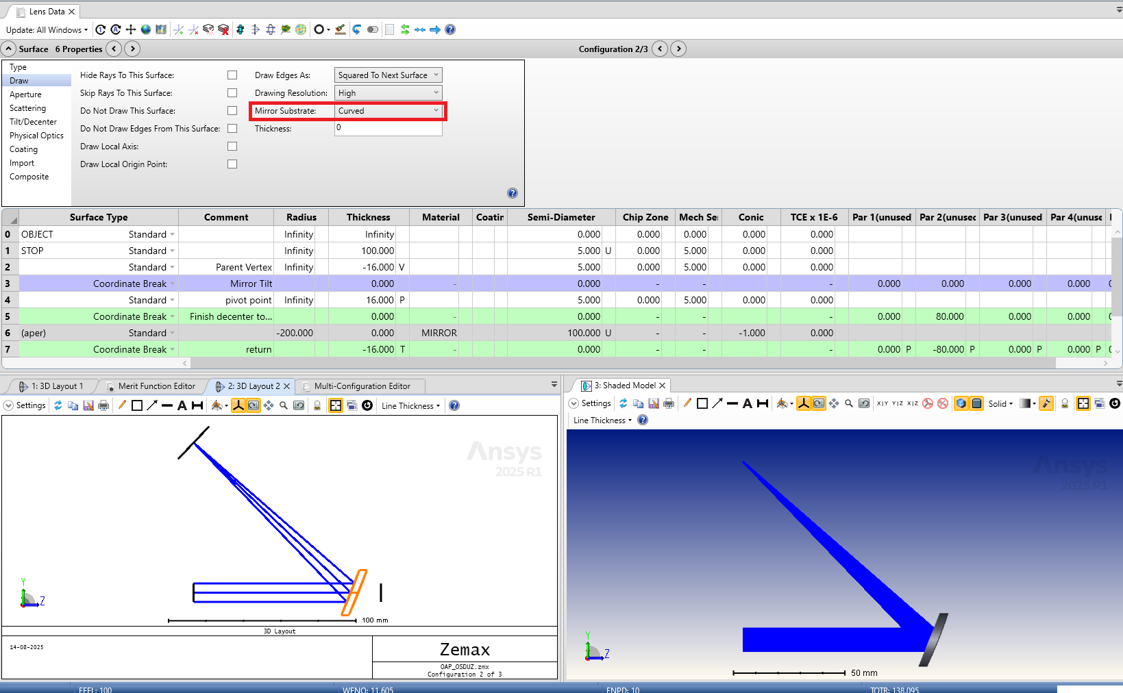

SubscriberYes, I have tried all the combinations in the Draw tab. Strangely, none of the choices from the 'Draw Edges As:' pulldown menu seem to do anything... they all appear the same in both the 3D Layout and Shaded Model viewers. However, the choices in the 'Mirror Substrate:' pulldown menu do change the form factor of the optic. But, none of them creates a uniform-ish edge thickness form factor. Aside from creating a custom volume in Part Designer, is there something I am missing. Please advise.

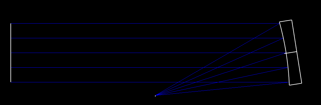

tariq.islam
Ansys EmployeeYou can set the mirror substrate to “Curved”, which will give it a form factor similar to what you’re looking for.
You can also refer to the help file, which describes this in more detail. Draw (surface properties)
August 14, 2025 at 3:51 pm
odurney
SubscriberThank you for the tip. I am aware of the curved substrate choice. However, it is not what I want. If the edges of the substrate were perpendicular to the mechanical axis of the OAP, I could make it work. But, they are slanted… creating a curved parallelogram.

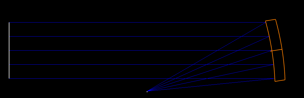

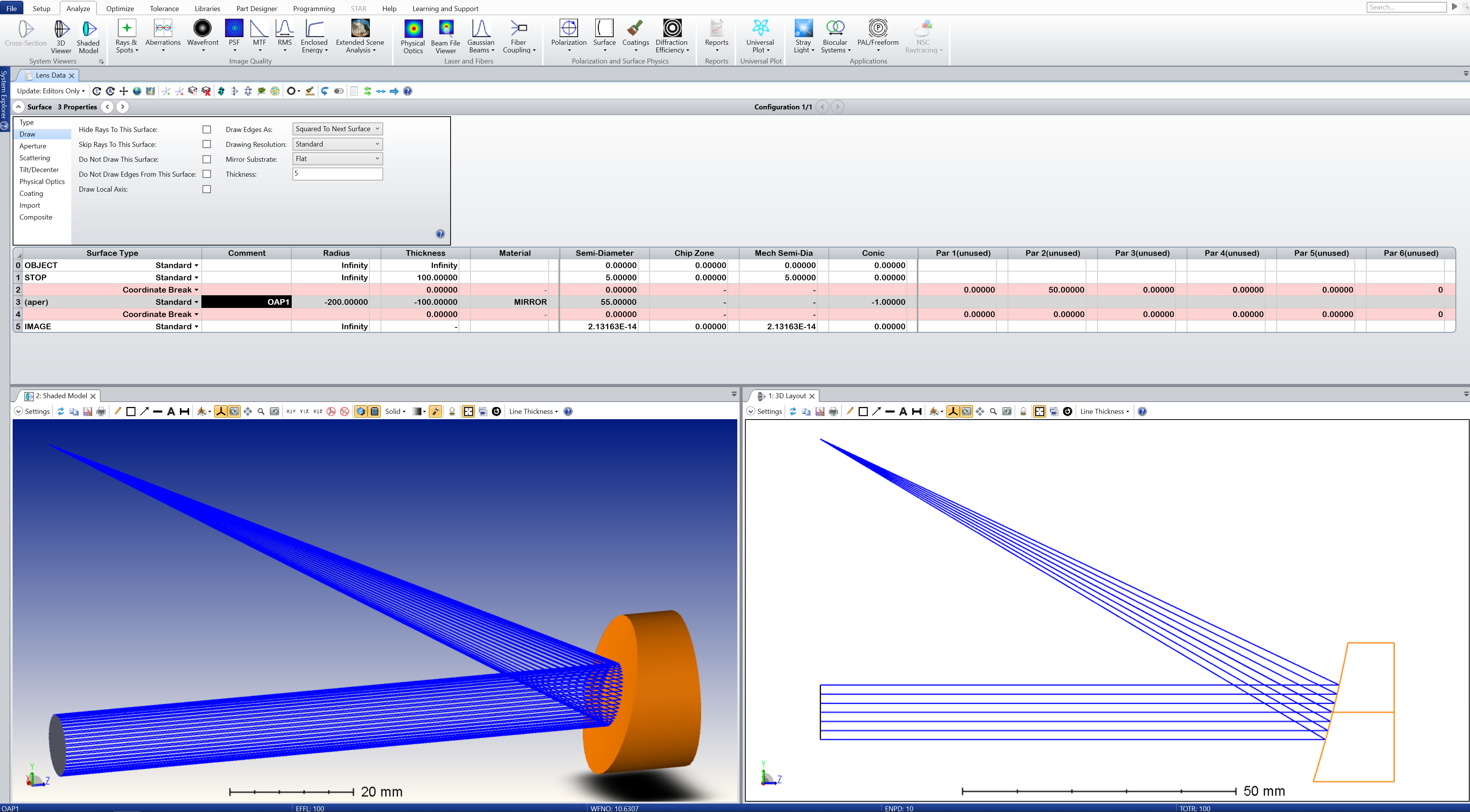

Chris Normanshire
Ansys EmployeeHello.
If you convert you OAP from a Standard surface type to an Off-axis Conic Freeform surface then you be able to get the profile you require. Please see this post (Convert a Standard off-axis conic into an Off-Axis Conic Freeform | Zemax Community) on the old Zemax community for instructions on how to perform the conversion.
Kind regards,
Chris
August 18, 2025 at 3:33 pm
odurney

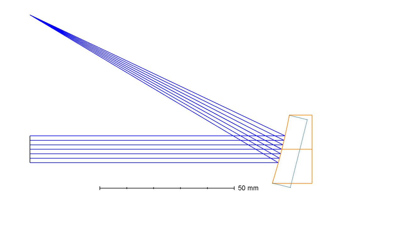

SubscriberThis looks similar to the 'curve' form factor, but the edges are perpendicular to the mechnical axis. Is it possible to have the back surface flat? I will practice. Thank you for the advice.
August 18, 2025 at 4:30 pm
August 18, 2025 at 4:37 pm
odurney
SubscriberThis is perfect. I am having some trouble following the instructions... need to figure out what is wrong. How would the instructions change of the OAP is after the focal plane?
