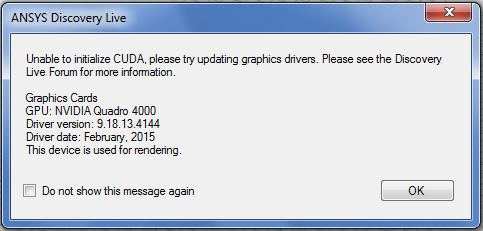

Ansys EmployeeHello SagarLive
Please check if you have nvcuda.dll files in your ANSYS Discovery installation directory and delete them. Once deleted, try reopening Discovery Live.
March 2, 2019 at 9:16 am
Sagar Patil
SubscriberNaresh Patre
nvcuda.dll files is not there in ANSYS Discovery installation
Any other option for this..
March 2, 2019 at 9:37 am
Sagar Patil
SubscriberSagarLive
After running compatibility software for hardware requirement getting below error message
Unable to determine CUDA Version. Discovery Live requires CUDA version 9.1 or later. Please check for compatible devices or try updating graphics driver.
Plz guide ASAP
