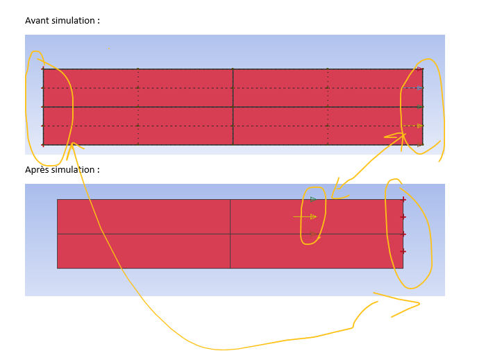

      I’m using a NURBS IGA mesh in LS-DYNA. After using refine, the boundary conditions and forces applied to control points change position in the LS-Run results.

      Even though I tried using the latest version of LSPP, the same problem still occurs.
      This issue appears right after the refinement step.
