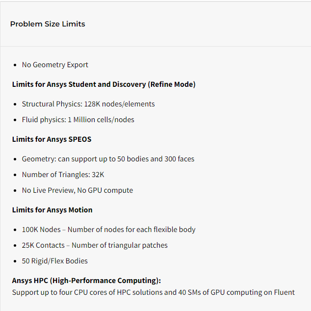

    • Akshay Maniyar
      Hi Kate,
      Please check the below image for more details on the size limit with a student license.
      You can reduce the model node count or upgrade the license so that you can solve the big models.
      Thanks,
      Akshay Maniyar
