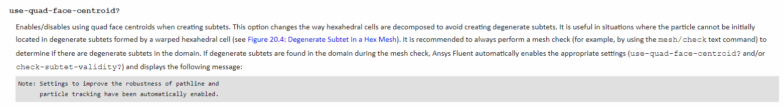

      when I open Fluent a Note appears aswell as after initialization. I dont know what it means and googling it did not provide any information. Maybe somebody here could tell me where its coming from and if its serious.
      'Note: Settings to improve the robustness of pathline and particle tracking have been automatically enabled.'
      Thank You in advance.
      Kind regards
    • Murari Iyengar
      It is a note from Fluent when degenerate subtets are found in the domain. You can click on Mesh check to ensure mesh is okay.
      You can find more information below.
      20.2.3. Tracking Settings for the Discrete Phase Model (ansys.com)

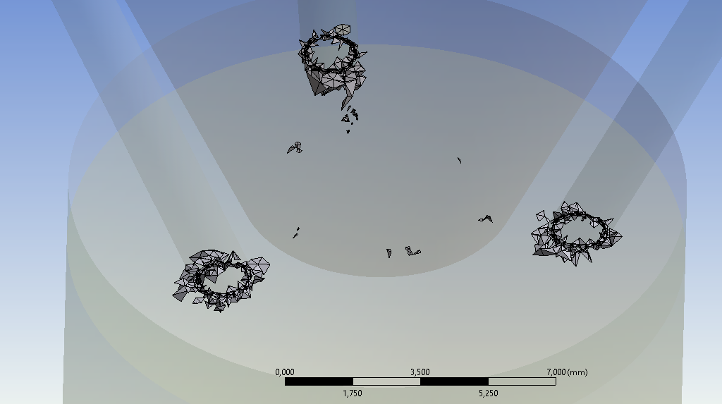

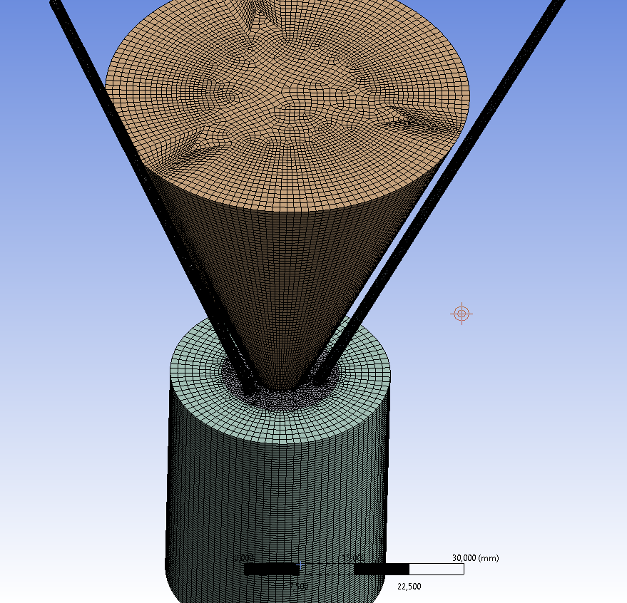

        I want to simulate a gas flow coming in from three small cylinders and in the middle (big cone). The streams move into the zylinders below. I am using inflation for the three small and the big inlet-cylinders.
        The worst elements i put in the photos. I tried almost everything i could think of and dont know how to mesh it better.
        The most problematic elements are at the boundaries between cylinders and

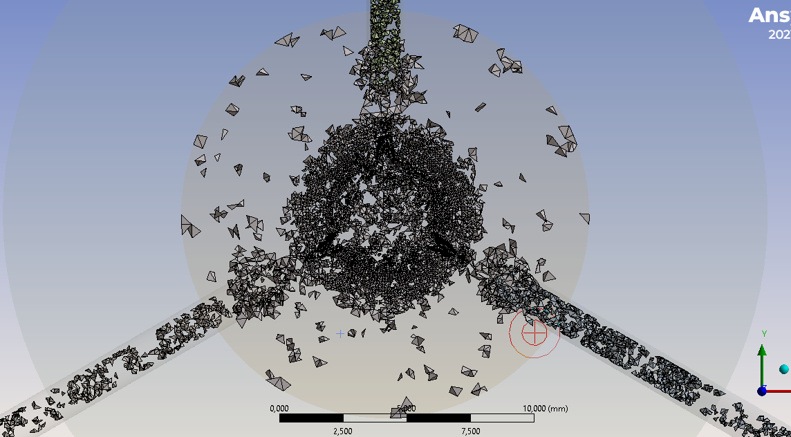

    • enie.dreyling
      And these elements aswell
      Which meshing method did you use? Please tell me it wasn't "hex dominant".  Breaking it like that takes some doing, so I suspect you've overconstrained something somewhere.
      • enie.dreyling
        No not at all. I used inflation layers, element sizes and some edge divisions.
        I dont know what to change.
      OK. I think you're suffering from the inflation layer(s) squashing the core mesh (inlet tubes) and the way Ansys Meshing treats inflation when joining volumes with a large angle between the inflated surfaces.   There's a fairly easy fix, which requires all volumes to be merged, then split the complex bit out as one zone, and the sweepable zones separately. Then use sequential meshing to mesh the middle first. Have a look at the meshing tutorials and Learning videos (icon to top left of this page).
      Because of the rules Ansys staff operate under I'm not able to give a detailed explanation, however others in the community aren't operating under the same restrictions.
