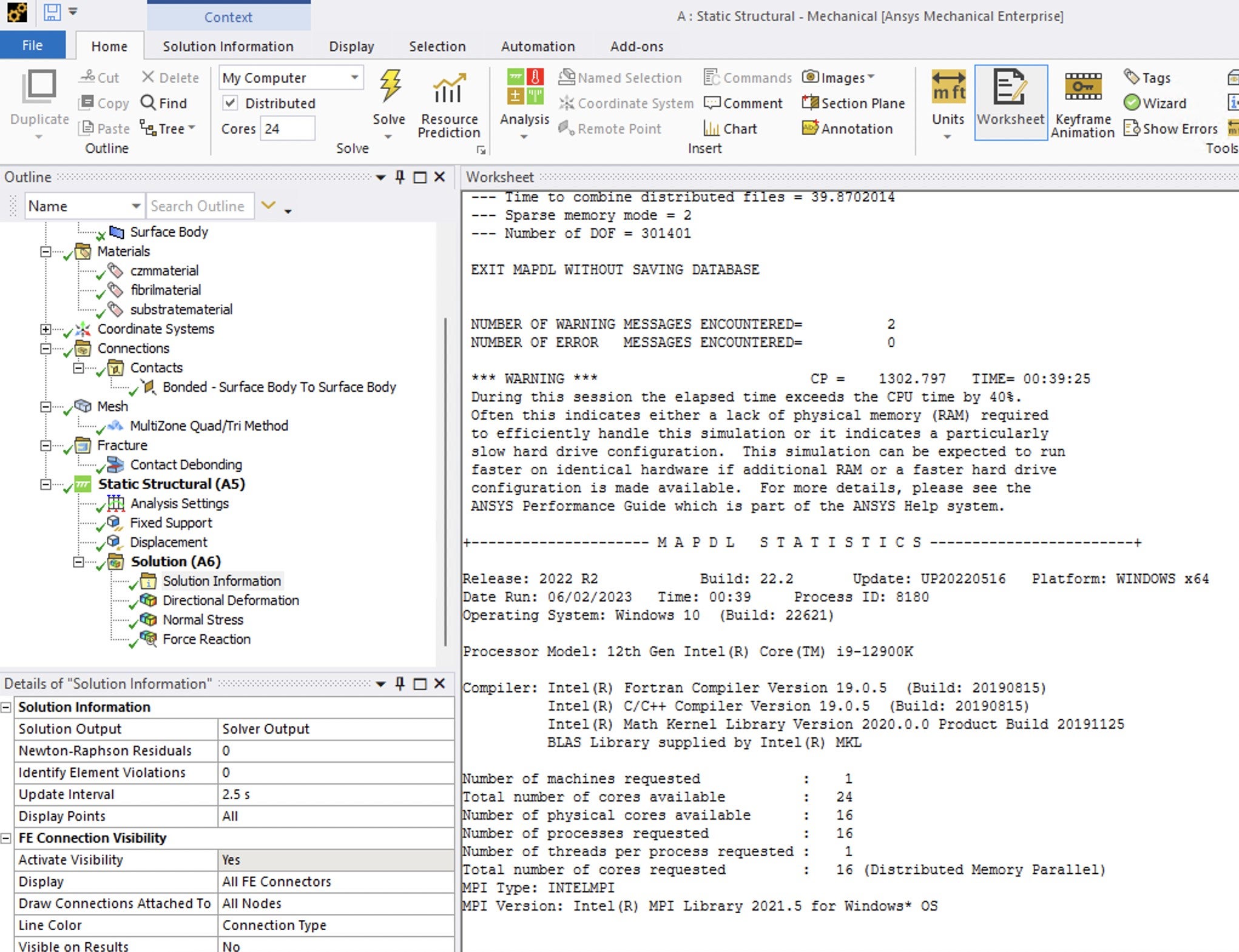

      HPC isn't using all 24 cores available, just 16 even though 24 are specified.

      MAPDL Solver can only use physical cores on your machine, it can not use logical processors that you see in task manager. I would recommend turning virtualization off and using about 14 cores on this machine, leaving a couple of cores for system-related processes.
