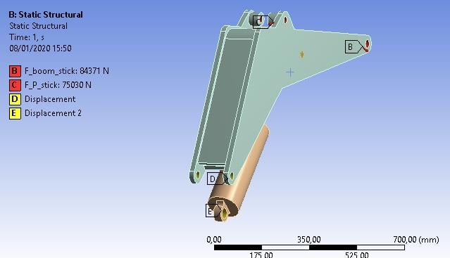

      The model is the boom of an excavator: in target D and E there are the connections to an hypothetical chassis; in target A there is the pin which connects the piston and the boom and permits the rotation. I put the constraints in order to create a three-hinged arch, so I chose the cylindrical supports to recreate the revolute joints (target A, D, E in the figure), blocking axial and radial directions and freeing the tangential one, but it didn't work: "Not enough constraints ..."
      So I tried another way: I created two cylindrical coordinate systems, one in target D the other in target E, and I put diplacements like in the figure below, blocking the translations and freeing the rotation, but the problem persists.
      Can anyone help me? What should i do to solve the warning?

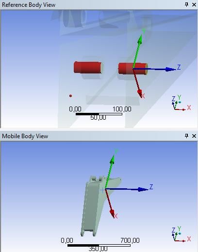

      Thanks for your reply. The first image below shows a better view of the structure and the displacement constraint: I selected the two internal faces of the holes which support an hypothetical pin that connects the boom to the chassis, freeing the Y rotation  and blocking the X and Z translations (same story for target E, selecting the internal face of the hole in the cylinder).

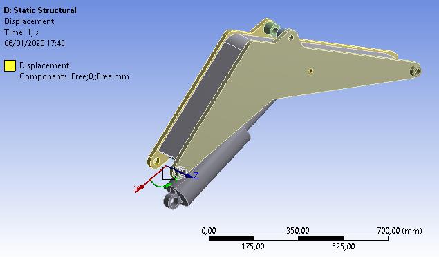

      The cylinder has been modeled as a rigid rod (so there's no chamber for the working fluid, but this is a full body, Figure 2) in order to create the three-hinged arch, so I can't understand why Ansys gives me the "Not enough constraints ..." warning everytime (the selected face for the cylindrical support is the external one of the green pin, target A).
      I also tried to launch the analysis adding some joints in the section "Connections": revolute joints in target D and E (Connection type: body to ground) and revolute joint in target A (Connection type: body to body as in figure 3), but Ansys shows me a warning about "Large deflection" that should be ON and the "Not enough constraints.." one.

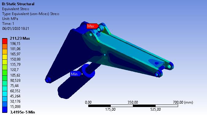

      The last figure shows the results with the "not enough constraints.." warning: they seem coherent, but the moment reactions in D and A are very high (the order of magnitude is e+005). D and A are two hinges, so I don't expect a moment reaction.
      I can't understand where I went wrong.

      The mistake is that you have created a cylindrical coordinate system and have set a 0 constraint on the Y-component of the cylindrical csys.  The X component is Radial and the Y component is Tangential. The first image above shows Radial is Free, but that is not what you want, you want that to be 0. Setting Tangential to 0 prevents rotation, when you actually want that to be free.

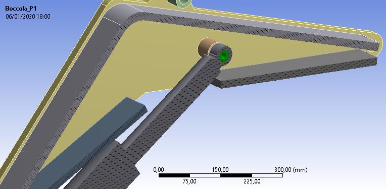

      Anyway, I think I solved my problems. In the old target A I made two slices of the pin which blocks the cylinder, in order to create three different patches of the external pin surface: I put a body-to-body FIXED joints between the extremal parts of the pin and the lateral plates, and a body-to-body REVOLUTE joint between the attack of the cylinder and the middle part of the sliced pin. Now, this is a fully-fledged internal hinge of the three hinged arch and no more a cylindrical support, which links the body to the ground and doesn't enable the blue part of the body to react to the loads! In fact, in the first simulation the cylinder is blue, but it shouldn't be blue, because it MUST HAVE a reaction directed along the axis of the cylinder.
      After that, I put two displacements in cylindrical csys (but it's the same putting two cylindrical supports) in target D and E, blocking the axial and radial directions and freeing the rotation. Now, these constraints link the boom and the cylinder to the ground, in fact the old blue part of the boom is now reacting to the force applied.
      I made a further check: I put moment and force reactions probe in D and E. Moment reactions are little more than zero (about 1Nm) and it's correct because the hinge constraint has no moment reaction; force reaction in E is now axial and it's also correct, because the cylinder works in traction or compression, so the reaction must be axial, and this is verified.
      The "not enough constraints .." warning still appears, but I think the results are coherent, aren't they?
