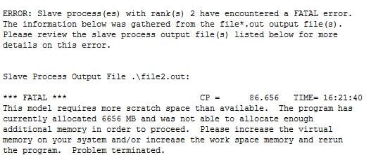

      Here is the ERROR I get on a big workstation.
       Number of equations was about 7.3 million.
       *** ERROR ***                           CP =     739.492   TIME= 08:11
       There is not enough memory for the Distributed Sparse Matrix Solver to
       proceed using the out-of-core memory mode.  The total memory required
       by all processes = 336902 MB.  The total physical memory that is
       available on the system = 176879 MB.  Please decrease the model size,
       or run this model on another system with more physical memory.

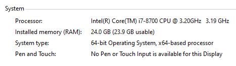

      How much memory is installed in your computer?
    • SJ123
      Hi Peter
      Thanks for looking at my model.
      The installed memory is 24 GB.
      If possible, could you please remove the unnecessary contacts from my model and upload it again. If not, suggest those unnecessary contact to be removed.
      The version I edited will not run on your computer because it requires 30 GB of free memory and you have only 20 GB of free memory. You have to increase the element size even more.

      I don't know why the solver is trying to run incore on a 24 GB memory machine when it calculated it needs 31 GB for incore.

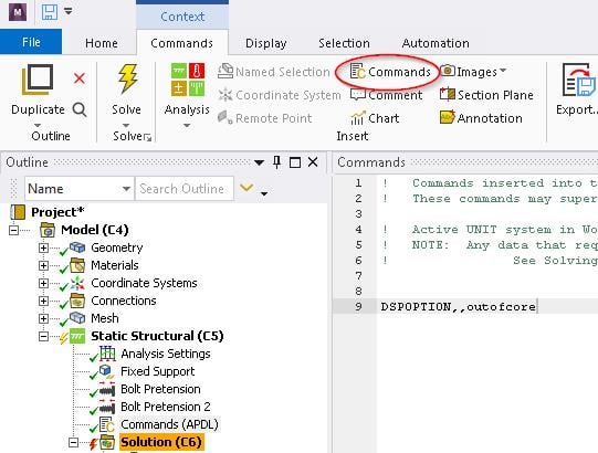

      Insert a command object to force it to run outofcore, pay attention to the double comma!
      DSPOPTION,,outofcore

      You did not insert a Command Object into the model.
      Click on Static Structural, then on the Environment tab click on the Commands button.
      Type the text shown.  Make sure to use two commas!
      As I said above, your computer only has 24 GB of memory, and ANSYS should automatically choose outofcore, but it is wrongly choosing incore which requires > 30 GB of memory.

      This time I have changed the thread contacts to frictional one and Ansys has automatically chosen outofcore memory.
      But now I am getting some other error. Please have a look.
      https://drive.google.com/open?id=1o9G9k22Oe16ULmjh2SMkBArT4o0g1UjW
      Shobhit, you need to develop your own skills at diagnosing problems with ANSYS solutions.  The previous errors where the solver suddenly stops running because it runs out of memory are a bit more difficult to diagnose, but I helped you get past that. Take a look at the Solver Output from this latest solve, find the error and try to figure out what it means. Depending on the error, there are different remedies. Examples of how to get past them can be found on this site, but first you have to understand the error.
