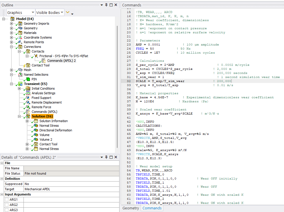

      I am following this example here: (https://ansyshelp.ansys.com/public/account/secured?returnurl=///Views/Secured/corp/v242/en/wb_wbtec/WBtecwear.html). I am trying to simulate fretting wear for a polymer pin and a metal flat using a 2D Archard wear model. I have scaled the wear coefficient to simulate wear for 10 million cycles in 1s. Below are the commands for the asymmetric frictional contact (only pin wears, COF 0.35) and non-linear adaptive meshing. I was able to generate a stress contour when the wear is off, but the stress contour disappears for the step where wear is ON. The number of contacting elements stays the same, as no real movement is simulated, just the wear coefficient. The solution converges, but no change in mesh happens, so no change occurs in the volume of the bodies. Why can I not produce wear? Here is a graphic for the model: https://imgur.com/a/XBmTeSH
      keyo,cid,5,1 !KEYOPT(5) = 1 is set to close the gap with an auto contact surface offset (CNOF)
      keyo,cid,10,2 !KEYOPT(10) = 2 is set to perform a contact stiffness update each iteration
      ! Wear model setup
      TB,WEAR,PIN,,,ARCD
      TBFIELD,TIME,0
      TBDATA,PIN,0,1,1,0,0 ! Wear OFF initially
      TBFIELD,TIME,1
      TBFIELD,TIME,1.01
      TBDATA,PIN,K_ansys,H,1,1,0 ! Wear ON with scaled K
      TBFIELD,TIME,2
      ANTYPE,STATIC
      NLGEOM,ON
      KBC,0 !ramped load instead of stepped (KBC=1)
      !ESEL,S,TYPE,,PIN
      !CM,wear,ELEM
      !*GET,numelem,CM,cont_wear,ELEM ! Returns number of elements in component
      NLADAPTIVE,all,add,contact,wear,0.50 !wear at any contact point exceeds 50% of the average height of the solid element underlying the contact element
      NLADAPTIVE,all,on,all,all,1,,2 !activate adaptivity
      NLADAPTIVE,all,list,all,all !list adaptivity settings
      Listing the parameter just in case:
      ! Parameters
      AMP = 0.0001 ! 100 µm amplitude
      FREQ = 50 ! 50 Hz
      CYCLES = 1E7 ! 10 million cycles
      ! Calculations
      S_per_cycle = 2AMP ! 0.0002 m/cycle
      S_total = CYCLES*
      S_per_cycle ! 2,000 m
      T_exp = CYCLES / FREQ ! 200,000 seconds
      T_sim_wear = 1 ! 1 second simulation wear time
      SCALE = T_exp / T_sim_wear ! 200,000
      V_avg = S_total / T_exp ! 0.01 m/s
      ! Material properties
      K_base = 4.56E-7 ! Experimental dimensionless wear coefficient
      H = 120E6 ! Hardness (Pa)
      ! Scaled wear coefficient
      K_ansys = K_base*V_avg*SCALE ! m^3/N·s
      *MSG,INFO
      CALCULATIONS:
      *MSG,INFO
      AMP=%G m, S_total=%G m, V_avg=%G m/s
      *VWRITE,AMP,S_total,V_avg
      (E10.3,E12.3,E12.5)
      *MSG,INFO
      Scale=%G, K_ansys=%G m²/N
      *VWRITE,SCALE,K_ansys
      (E12.3,E12.3)
      !TBDATA,mat_id, K, H, m, n
      ! K= Wear coefficient, dimensionless
      ! H= hardness, N/m^2
      ! m=1 !exponent on contact pressure
      ! n=1 !exponent on relative surface velocity

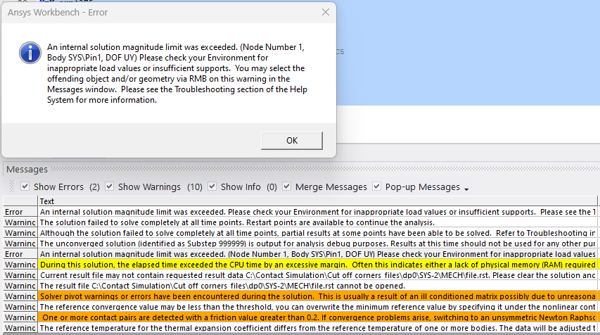

      I have your file and downloaded the reference TD-43 to compare.  The first time I ran TD-43 it failed to converge and I was given a warning that the units I used to Solve did not match the units used when the Command Object was created.  I changed the units to match the comments in the Command object and it solved without an error. This is a common mistake that can be mitigated by editing the Solver Units under the Analysis Data Management in the Analysis Settings.  Instead of allowing the Active System to be used, set it to Manual and pick the units system that matches the data in the Command objects, then it doesn’t matter what the active units system is when you hit the solve button.
      I noticed in your model, there is a Warning.
      Looking at your Command Object comments, it looks like all the numbers that require units are in the mks system.

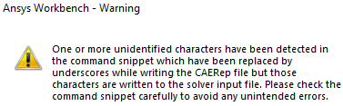

      Here is another warning that is related to Commands (APDL) 2.
      I don’t know what caused this warning.
      One more warning is this:
      One way to do that is to change from N to kN on the units, but that comes with changing the length scale to mm and the time scale to ms then all the numbers in the Command objects have to be scaled also.  I quickly made that change and that got rid of the warning, but I didn’t scale all the numbers in the command objects to put them in the new units. Another method to treat this warning is to change the Contact Normal Stiffness to Factor and use a value << 1 to soften the contact. Let’s see what the Ansys experts say on this warning.

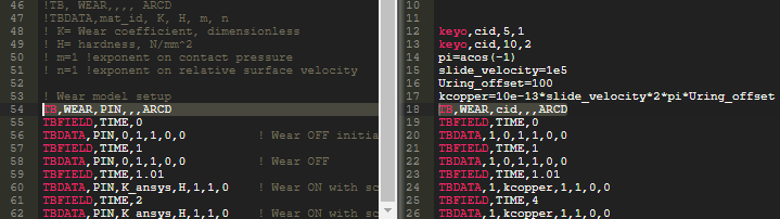

      Here is a side-by-side comparison of a portion two command objects that are inserted below the Frictional Contact.
      Your model on the left                                   TD-43 on the right.
      The highlighted difference between TD-43 is it uses cid, the contact id.
      TB,WEAR,cid,,,ARCD
      while your model uses a Named Selection PIN body.
      TB,WEAR,PIN,,,ARCD
      Reading the Ansys Help page for the APDL command for TBDATA, the first argument is the starting location in table for entering data. It seems like the first argument should be numeric. I will see if editing these few lines to look more like the reference example helps.

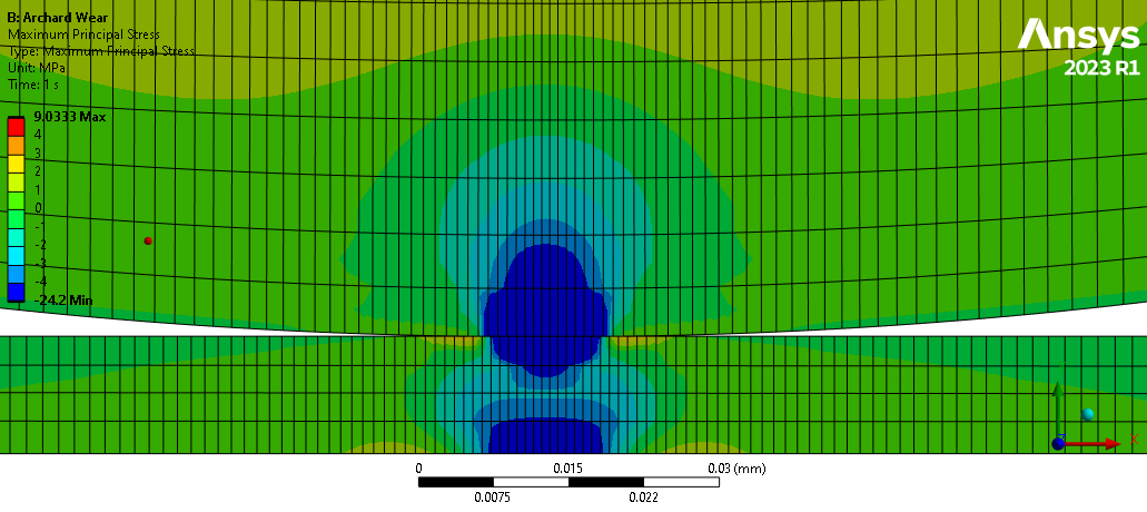

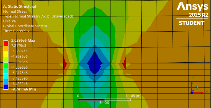

      This model has a very light down force of 0.25 N per meter of depth for Plane Strain.  Have you tried running it with a very high down force just to see if some wear occurs?  When I ran with 250 N, a few more nodes came into contact, but there was no wear happening. I expect the model will be improved by using a smaller element size so more nodes are in contact under load.
      First image is with 250 N, second image with 0.25 N of down force per meter of depth and there are only 2 nodes contacting at the end of step 1.

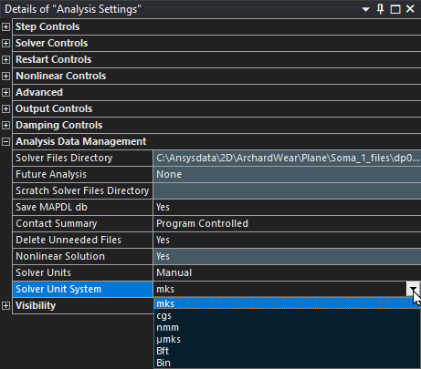

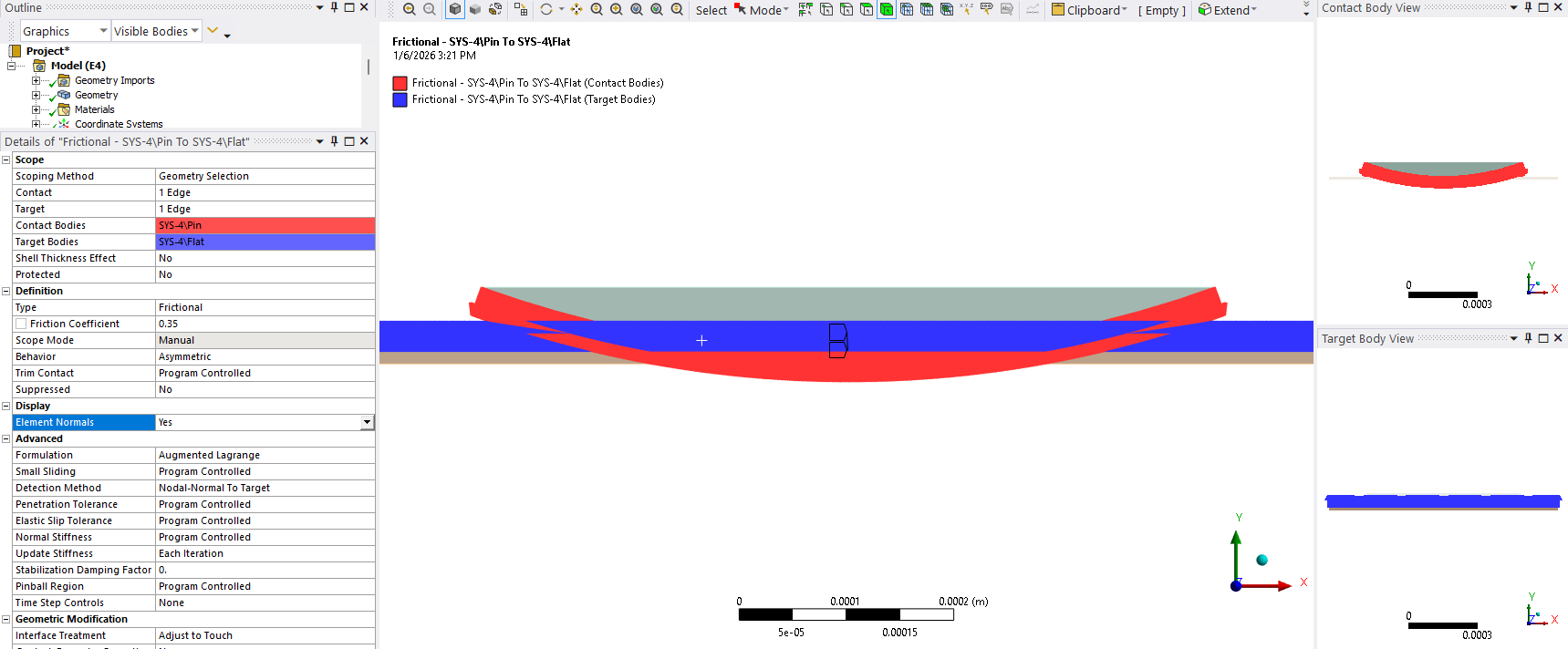

        1. I changed the unit system as you suggested. I believe I have consistently used MKS units; however, the SpaceClaim geometry model was on a small length scale. Not sure if that matters, because the warning went away after switching to manual.
        2. I also do not know what is causing the unidentified character warning.

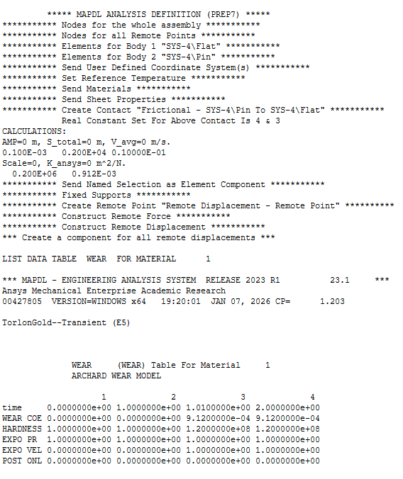

        4. The element information on the Named selection PIN body is read by the solver. Here you can see the wear table input for material 1.

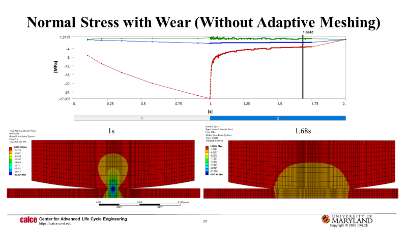

        5. I agree with you, I tried a static model, and that did not change anything. However, I was able to obtain this Hertzian contour below (static on the left, transient on the right), by a) changing the 2D behavior to Plane Stress with a thickness of 380 microns b) gradually increasing the load in multiple steps. However, no luck simulating wear yet. The reason behind the differences between static vs transient stress contours could be due to the gradual application of load for the static case. I kept the number of load steps = 2 for the transient one, similar to the file uploaded.
        6. If my Archard wear cmds are okay, is it possible to model wear without employing NLAD?
        7. I have tried changing the wear coefficient and normal load to force wear. Changing the wear COF did nothing. Increasing the load brought more nodes into contact, but no wear.

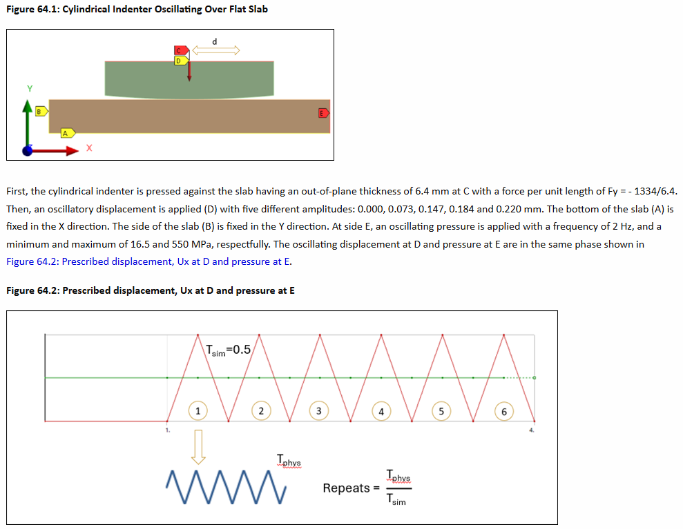

      There is a Technology Showcase for Fretting in Chapter 64 that may be worth studying.
      https://ansyshelp.ansys.com/public/account/secured?returnurl=/Views/Secured/corp/v252/en/ans_tec/tecfrettwear.html
      In that model, a lateral displacment of the cylinder block back and forth along the X axis as it pushes down on the flat slab.

      A good way to develop complicated models is break it down to the simplest model you can imagine that demonstrates the most important feature and get that working first.  In your case, the most important feature is to see wear occuring, so yes you should definitely eliminate the complexity of the remeshing.

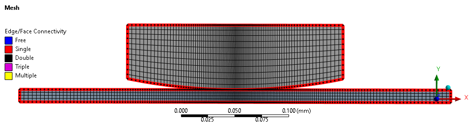

      Edit the shape of the cylinder portion and cut off the pointy ends to make meshing easier to control and get nice quad elements. Use an Inflation mesh control to set the First Layer Thickness on the bottom edge to get a tall element instead of a short element to leave room for the wear to eat up the element height and keep going without needing a remesh.
      Hello Soma,

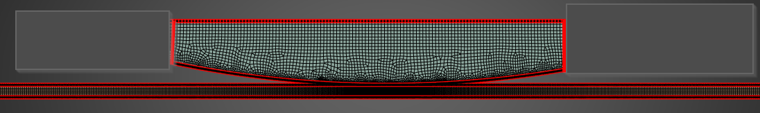

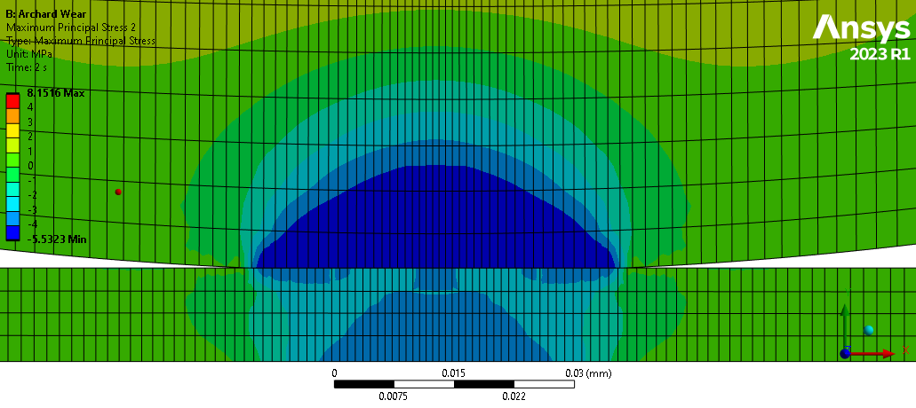

      Good progress was made by starting from scratch.  I constructed your geometry in SpaceClaim using mm instead of microns and clipped the ends off. I meshed the geometry using tall elements on the pin so that wear could happen without remeshing.  I biased the mesh to the center so there were 13 nodes contacting at the end of Step 1 of a Static Structural anlaysis, then as the wear progressed, more and more nodes came into contact.
      I setup the contact the same as you had. I used the APDL commands from TD-43 to paste into the command object under the contact, so the values are rubbish, but at least wear is occurring!

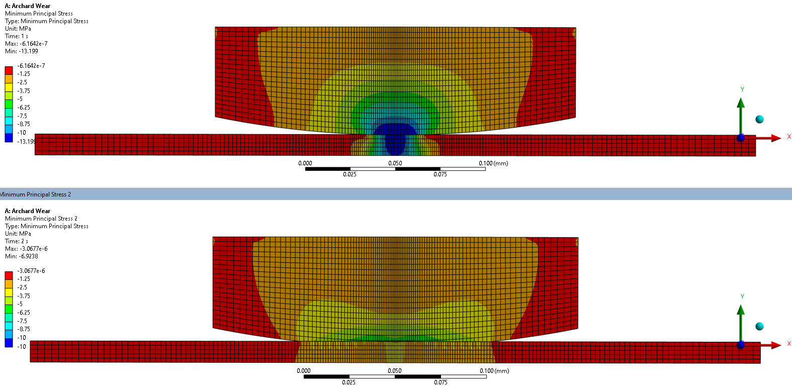

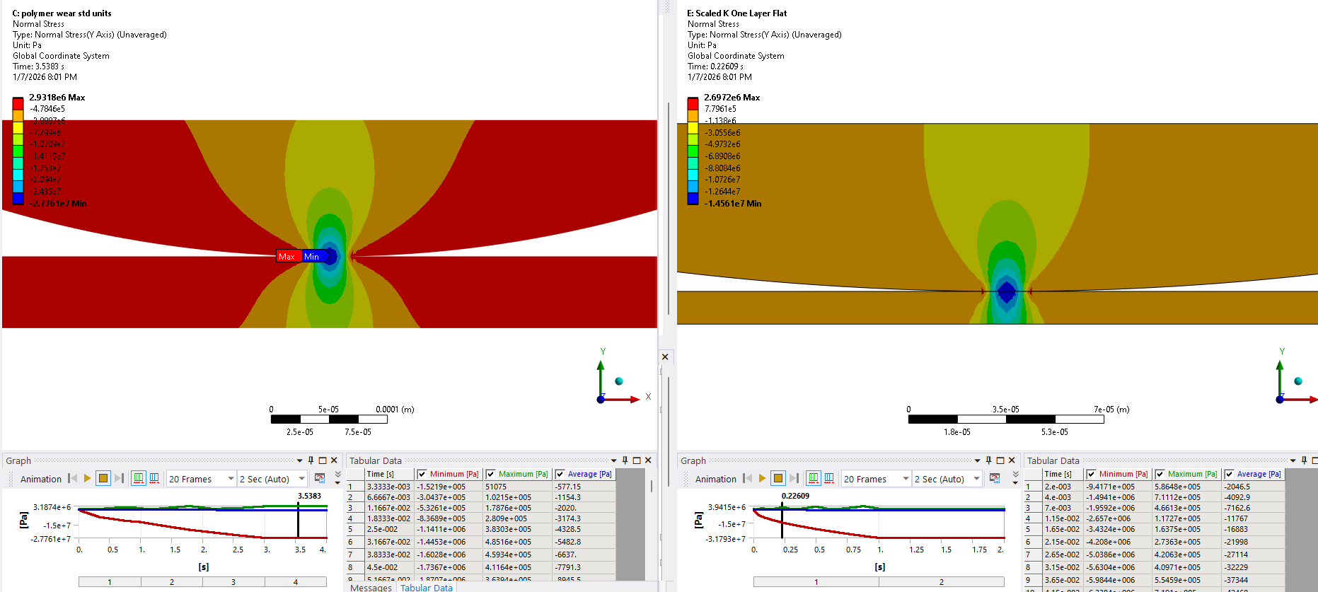

      Below is the stress at the end of step 1.
      Below is the stress at the end of step 2 which is only 2 seconds of time, not the 4 seconds from TD-43.
      Here is a link to the Ansys 2023 R1 archive. https://drive.google.com/file/d/1wbl5B6-KZwDLJULWV3Qt_Lobq1jgMagL/view?usp=sharing

      This is great! I used the geometry and mesh from your Ansys file, set the unit system to a manual nmm, and used these commands below for wear (without adaptive meshing). The contact elements wear about 50%, contact pressure drops to almost zero, and then the analysis is terminated after about 0.7s of wear due to an unconverged solution.

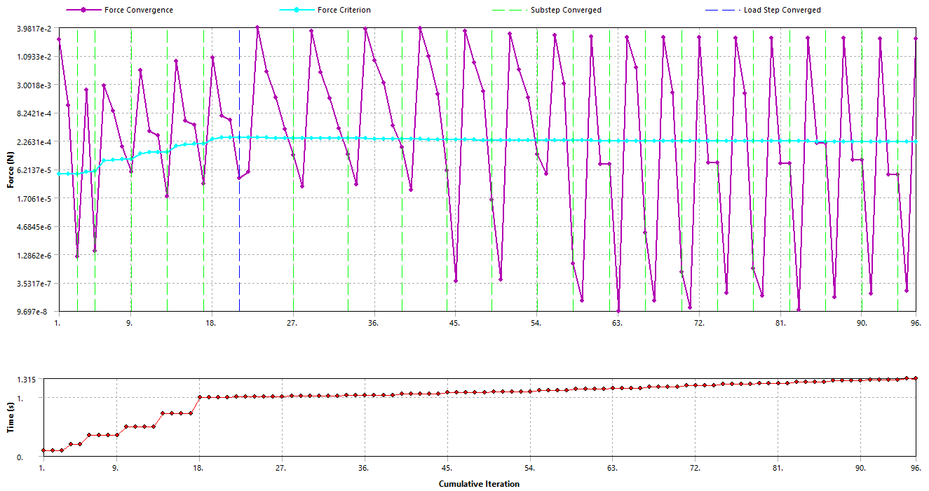

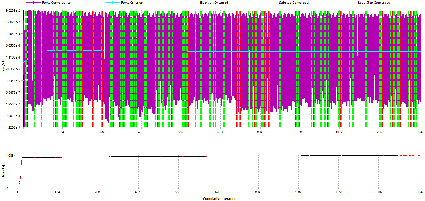

      I believe the errors are due to an insufficient amount of penetration in the contact relative to the wear increment. The penetration must be larger than the wear increment or the contact elements will go from a closed status to an open status resulting in rigid body motion. To prevent this, a very small time increment is used so that the wear increment is also small.  Another way to achieve this is to allow more penetration by softening the contact.
      Look at the TD-43 result.  At the end of step 1, it has contact penetration of 0.04 mm with a contact length of about 20 mm.
      I ran your model with the real wear parameters from above and at the end of step 1, it has a penetration of 0.000008 mm with a contact length of 0.01 mm.

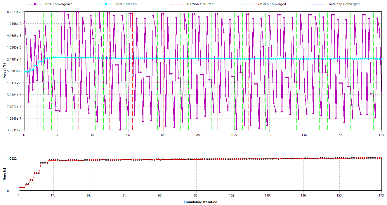

      TD-43 had no Bisections, your model has a lot as shown in the image below.
      I changed the Normal Stiffness and set it to a Factor of 0.01 as a trial. That made the Contact Penetration at step 1 be 0.0002 mm but it completely resolved the Bisection problem.
      A second trial of a Normal Stiffness Factor value of 0.1 shows the Contact Penetration at step 1 to be 0.00005 mm but the bisections have returned.
      Another way to fix the bisection issue with less penetration is to set the maximum time step to a smaller number, which will require longer solution times.

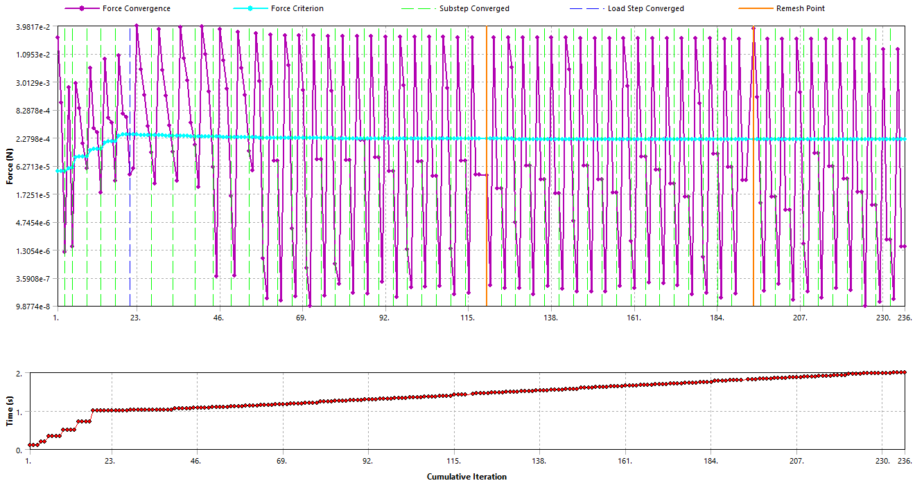

      I changed the Mesh details and set the Element Order to Linear and cut the element size in half then inserted the NLADAPTIVE code for an end time of 2 s and the remesh is working!
