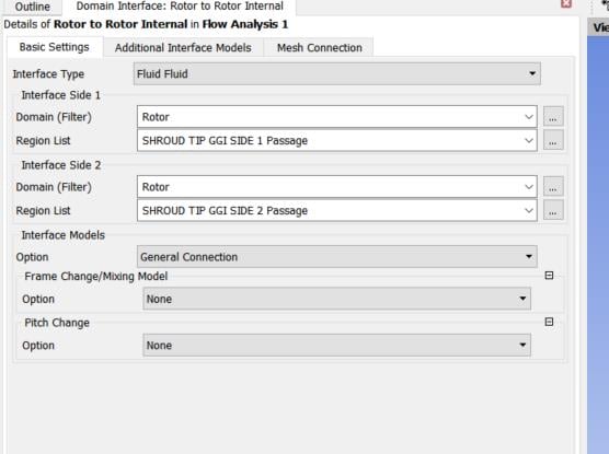

      First of all you work only on the CFX component disregard the Mechanical part. Just create the interfaces in CFX and include the interface for the internal GGI inerface (tip). You can just connect the CFX to Turbo Grid and work then this out.
    • lizm
      Could you please elaborate more on the GGI  inerface (tip)?
    • Amine Ben Hadj Ali
      Here the interfaces I have
      and here the internal interface which connects the shroud tip sides (created in TurboGrid)
