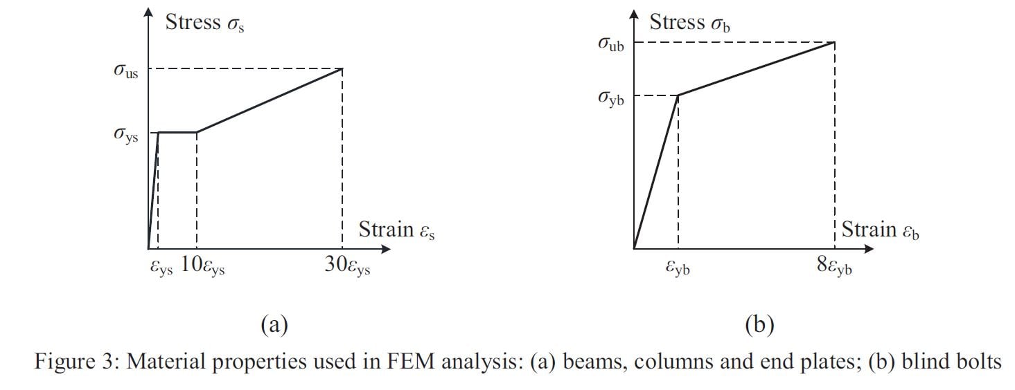

       i  study model with non stress strain curve how could i define it in ansys material (multi linear isotropic hardening)
      when calculate these values:
      True Strain = ln(1+Strain)   where ln is the natural logarithm function.
      True Stress = Stress(1+Strain)
      Elastic Strain = True Stress/E
      Plastic Strain = True Strain - Elastic Strain
      where:
      fy=309 mpa
      fu= 580 mpa
      E= 210 gpa
      i get:

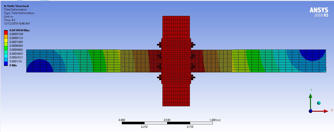

      but the deformation decreases from 0.006 to 0.001 and still solve linear i donot know what is the problem
      Please write a few paragraphs to explain, with images inserted, what you mean by that last part. I don't know what you are talking about.
    • Ayman

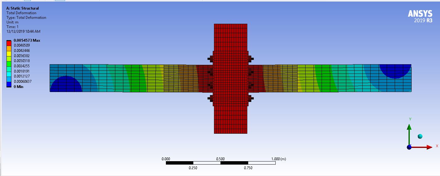

      when i solved linear the total deformation (0.006) m
      when i start non linear by the above input the total deformation change to 0.001
    • Ayman

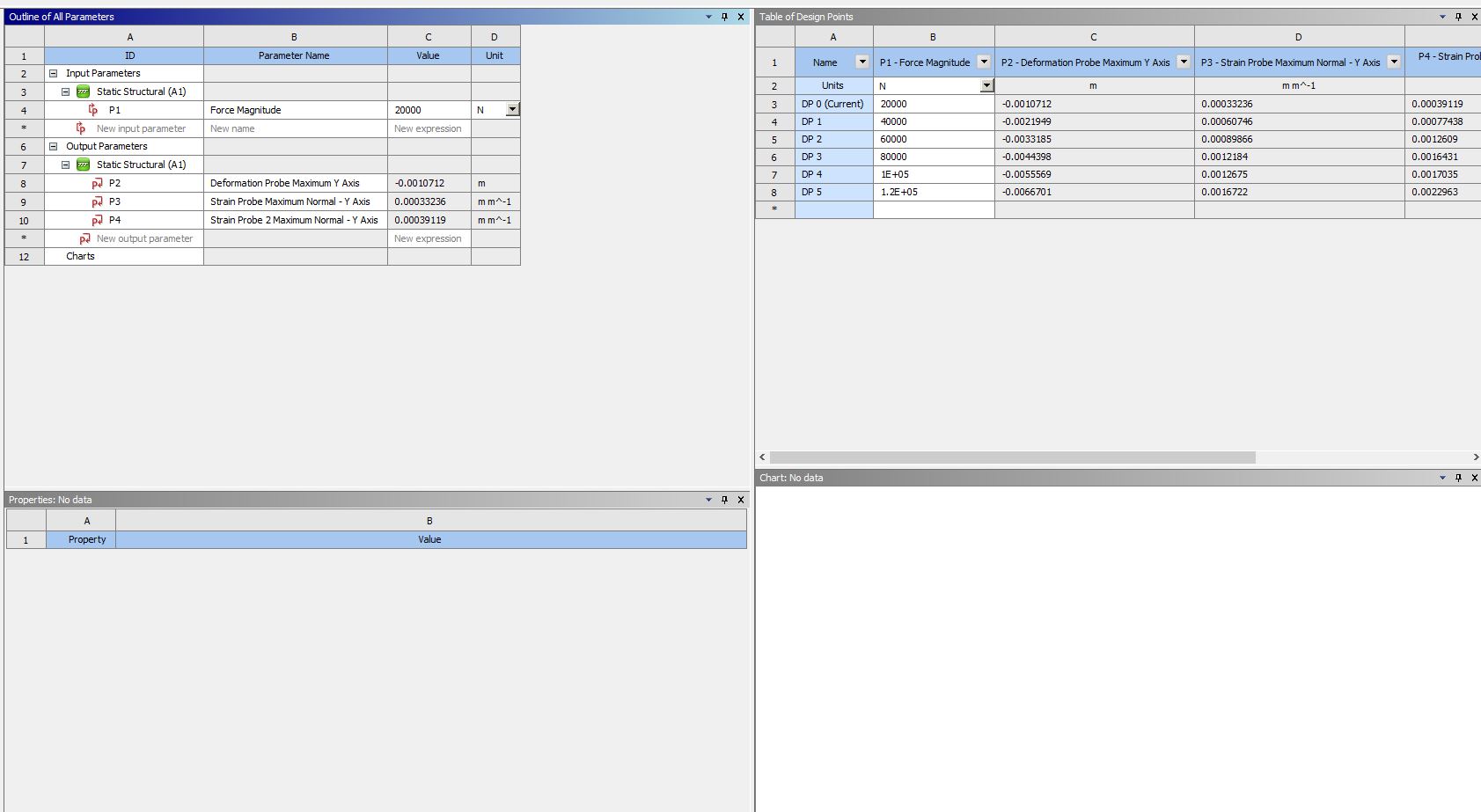

      and when i increase the load from 20000 N to 120000 N the output of deformation stil linear (0.001,0.002,0.003,0.004...)
    • Ayman
      @peteroznewman can you still help me with this problem
      The results are showing two different Time steps.
      If you plot the same Time, then the results will not be so different.
    • Ayman
      Thanks @peteroznewman thats was very helpful
