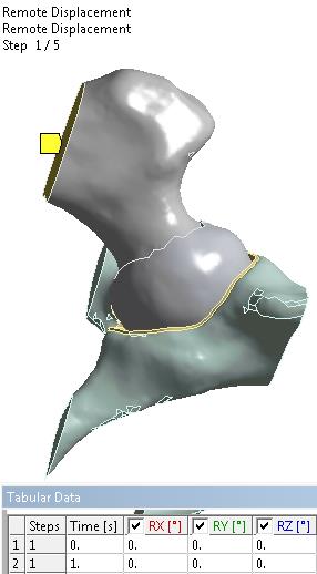

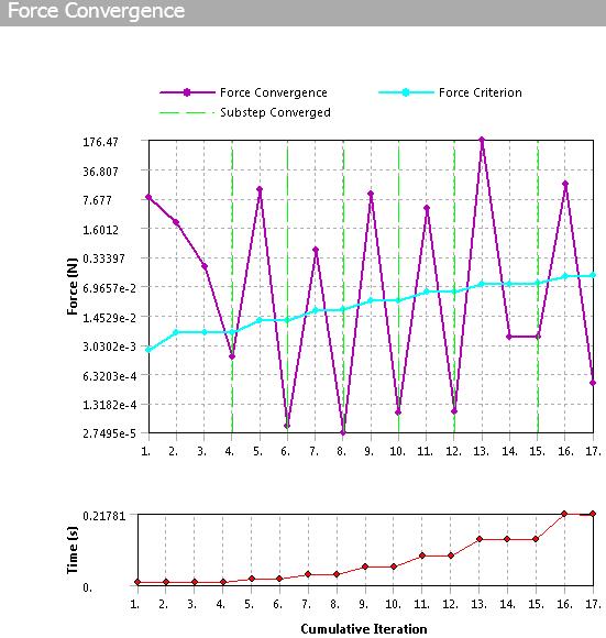

I'm trying to run a non-linear analysis in Ansys Workbench 18.1, but the solution is not succesfull. I tried many things out to make it work. Besides I run a very similar model with exact the same boundary conditions and forces and this works. I don't understand what I'm doing wrong.
The following error is displayed: An internal solution magnitude limit was exceeded. (so there is movement somewhere?)
I have tried closing the gap in the contact, apply the load in 5 substeps instead of 1, but it still won't work and I don't know what to try more.
Does anybody know what I could try furthermore to make the simulation work?
Thank you very much.
Regards, Kim

The error is that things are flying away. Most likely it is the part where the load is applied, or that the load is too high.
(Also rotational restrains on bricks are a bit odd, even though it might work since you are using a remote displ., need to try this out, did and it works, since the constraint equations there, will transfer the rotations to eq. translations)
So to try this out please, do the following:
Change the frictionless to a bonded contact, and use only a 1 N force. Use also weak springs, under analysis settings.
If this does not work, then it might be the contacts not working, so insert a contact tool under connections to see the status (closed, open, etc..)

peteroznewman
Subscriberkkvv2,
I understand the zero rotations on the cut face. You want the ball and socket joint to be free to translate in any direction as the load normal to that same cut face is applied.

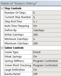

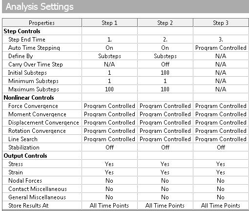

I changed the Frictionless contact to Frictional and used a small value for the COF of 0.05.
I changed the Analysis settings as shown below:
Step 1 is now solving.
This is much better than what you had. I don't know if it will complete to the end of Step 5, but you can find out.
Regards, Peter

Thank you very much for your detailed answer. I tried exactly the same as you did (first only 1 step) with frictional contact of 0.05 and interface treatment of "Adjust to touch". The Weak Springs and large Deflection ON and with substeps and direct solver. But I still get an error: "An error has occured in the Distributed Sparse Matrix Solver while factoring the matrix. error code = 18." Am I doing still something wrong?
Regards, Kim
January 25, 2019 at 4:39 pm
peteroznewman
SubscriberHey Kim,

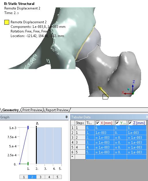

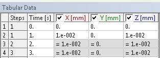

While my advice above was a good next try and seemed to make progress, the progress was illusory. The convergence was only against the weak springs and the proper contact did not develop. The first converged substep had a displacement of 10 m!
The next try is to Promote to Remote Point the first Remote Displacement, then add another Remote Displacement BC (scoped to the Remote Point) to hold the translational DOF on the remote point for an initial, very small displacement and let the proper contact develop, then deactivate that BC and continue the solution. I turned Weak Springs off for this to prevent the illusion of progress from being displayed. Step 2 will need Auto Time Stepping set On and Initial Substeps set to 100.
This method allowed the first step to converge. The trick is to get the second step to converge, which is not yet working.
Regards, Peter
