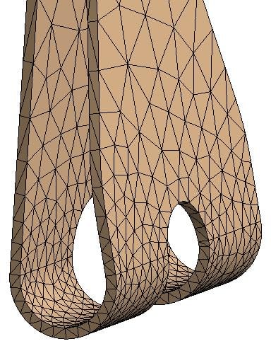

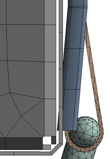

I set the number of steps to 1, since you only have one load, gravity. However, the solver will not converge in 26 iterations with 100 substeps. If you look at the NR Force Residual, all the points are around the brown strap.Â

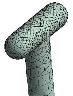

Here is a closeup on the geometry
Here is the mesh

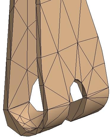

Here is a better mesh made by putting a Sizing Mesh Control on the 8 edges at the bottom of the strap.
While you are in the area, you can also add a Sizing control to the face of the solid part that the strap holds onto. That was too coarsely meshed also.

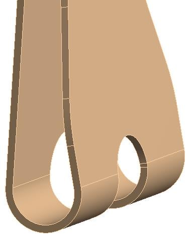

While a better mesh (on all four straps and Tee bolts) will allow the convergence to continue, it would be ideal to midsurface the straps. Do you want to do that while you are fixing the next issue?

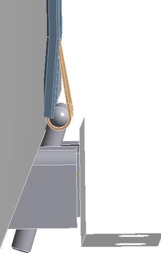

The next issue that prevents convergence is the interference between the large light grey sidewall and the darker grey strap backer. The solver is trying to resolve that interference. Do you want to resolve it in the geometry editor and get rid of that interference? Then the model should converge.

Subscriber One idea to save you some time in the Geometry editor fixing the interference. Just remove that one strap face (actually 4 faces) from the contact definition so that the solver is not checking the faces that penetrate the tank. All the other faces of the strap that wrap around the tank are fine.

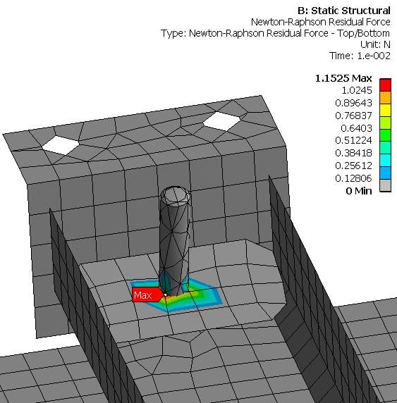

Now the NR Force Residual shows a problem on the No Separation contact.Here is the No Separation contact.
I don't understand why a No Separation contact is used here.
Why not use a Bonded Contact so that the Tee bolt stays at its current location on that midsurface plate?

yes I faced the same problem, the idea behind that was once the initial model is finalized, I want to put the initial tension in the belt to hold the tank steady. So I used no-separation to allow the movement along the axis of T bolt. I am not sure if this is the right approach.
So what I did was, I converted the following contact as bonded. I am still running the model, so can't comment on the results.

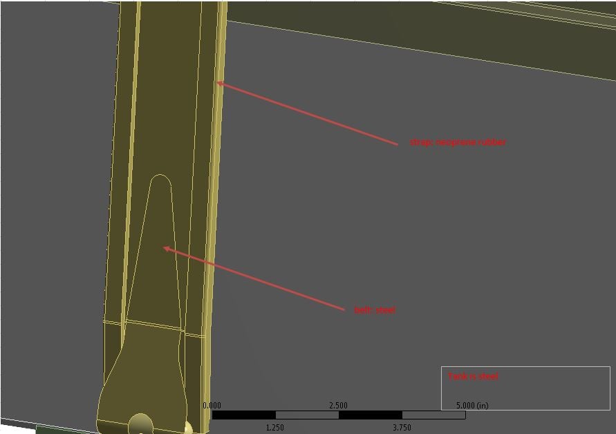

Now I have introduced the material properties as shown below:
So, I want to know if it will be ok to use the pure penalty formulation with neoprene?

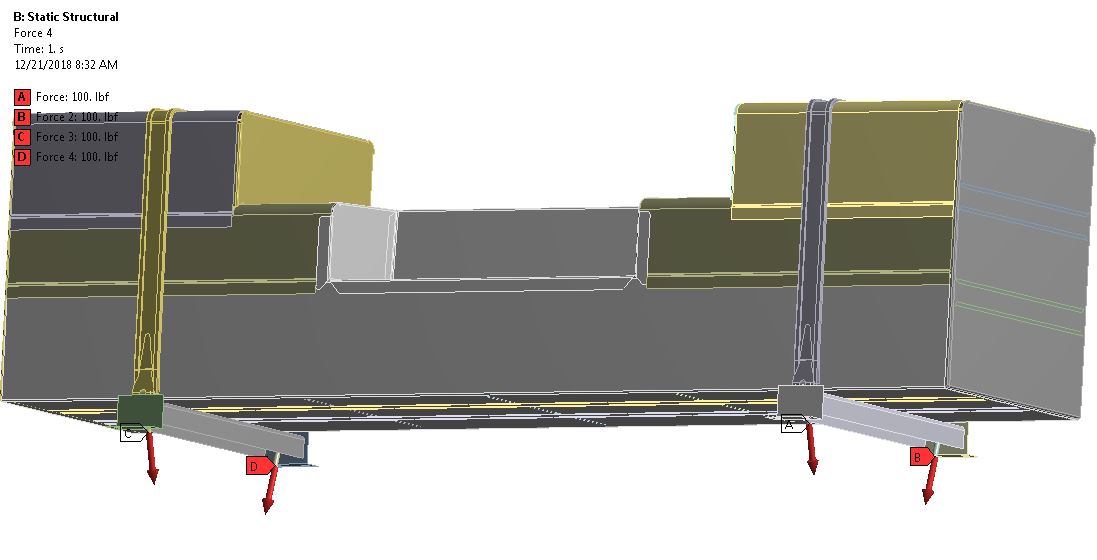

Also, if I want to introduce the tension in the belt, what will be the right way to do that? Right now what I am doing is applying force at the bottom of T- bolt, I don't know if it is right or wrong?

SubscriberOhh, so the image up there is blurry, adding more information the belt inside is steel, outside strap is neoprene and tank is steel.

Applying force to the T-bolt is good as long as it has freedom to move. If you changed the No Separation contacts between the T-bolt and the plate with the hole in it to Bonded Contact, then the T-bolt can no longer slide and the Force is not tensioning the strap. Instead of No Separation Contact, suppress that and insert a Translation Joint between the T-bolt and the plate with the hole. Make sure the X axis points along the length of the T-bolt. You then apply a Joint Load of Force to the Joint.
