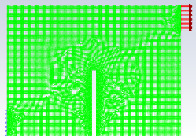

I am modelling the condensation of humid air on a cold wall in a room with a reasonable mesh quality, as shown in the figures below. Hot outdoor air will enter the room with a velocity of 1 m/s and a temperature of 308.15 K. The cold wall has a constant temperature of 289.15 K. The air flow, temperature distribution and humidity levels are the subjects of interest in the study.

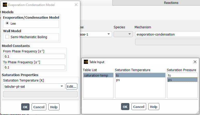

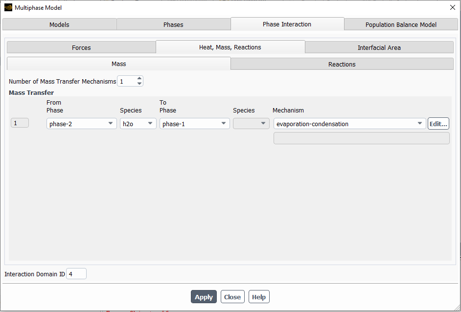

After conducting some literature review, I am using Multiphase model (Mixture) with Species model (Species Transport), where phase 1 is water-liquid and phase 2 is a mixture-template of water-vapour and air. Phase 2 water-vapour will condensate into phase 1 when the cell is at saturation temperature. Realizable k-epsilon with enhanced wall treatment is used for the viscous model.

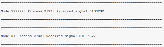

The error message "Node XXXXXX: Process XXXX: Received Signal SIGSEGV" occurs when I click on initialization, both hybrid and standard initialization give me the error. Whenever I get this error message, Fluent crashes and it couldn't be opened again until I reboot my computer (all the settings have gone missing and I need to setup again). I also experienced the same issue when I used my university computer. This error shows up every single time when I click on the initialization.

Forum ModeratorWhich can mean the time step is not suitable for the mass transfer rate, or that the mesh isn't refined enough (or is too fine) to capture the gradients. If you plot RH what does the contour look like? Please post the image here.Â
