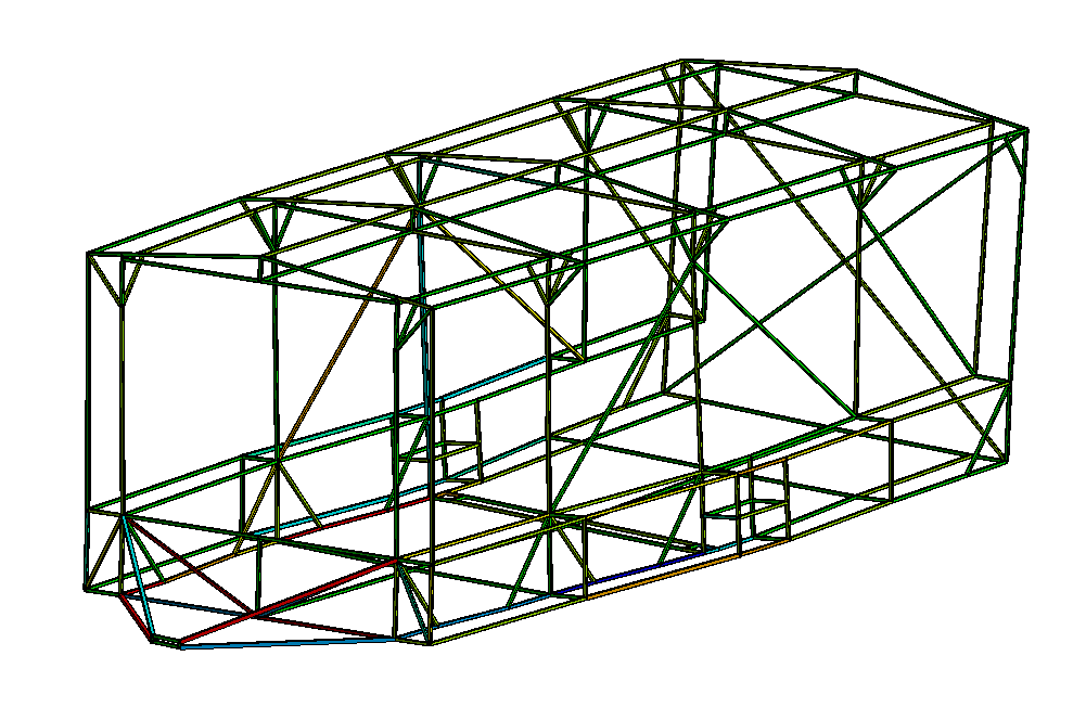

SubscriberHello, I am calculating axial forces in the link elements of a truss structure. I have used an APDL snippet to merge the nodes of all the links together (at the bottom of the post). When I solve the model, I do not get any error messages. Also, when the view is set to "Thick Shells and Beams", everything seems fine (see fig. 1).
However, when I disable "Thick Shells and Beams", the elements seem to be all over the place (fig. 2).
Are my results somehow influenced by that or is this a mere display feature?
Thanks in advance
APDL Command:
/PREP7! 1. Select everything to ensure the merge affects the whole model
ALLSEL, ALL! 2. Merge Nodes
NUMMRG, NODE, 0.020, , , LOW
! 3. Compress Node Numbers (Cleanup)
NUMCMP, NODE! 4. Merge Elements (Optional but recommended for trusses)
NUMMRG, ELEM! 5. Return control to solver
ALLSEL, ALL
FINISH

Ansys EmployeeHiÂ
Seems you use WB/Mech.
No need for these commands that are not recom.
So instead use shared topology/multi-body part (Seacrh this up there are videos), to connect beam/line geom. - see here how it is done:
Frame Analysis - FEA using ANSYS - Lesson 4
Mesh with 1 division per member/line body (mesh size object )and set type to truss not default beam.
All the best
