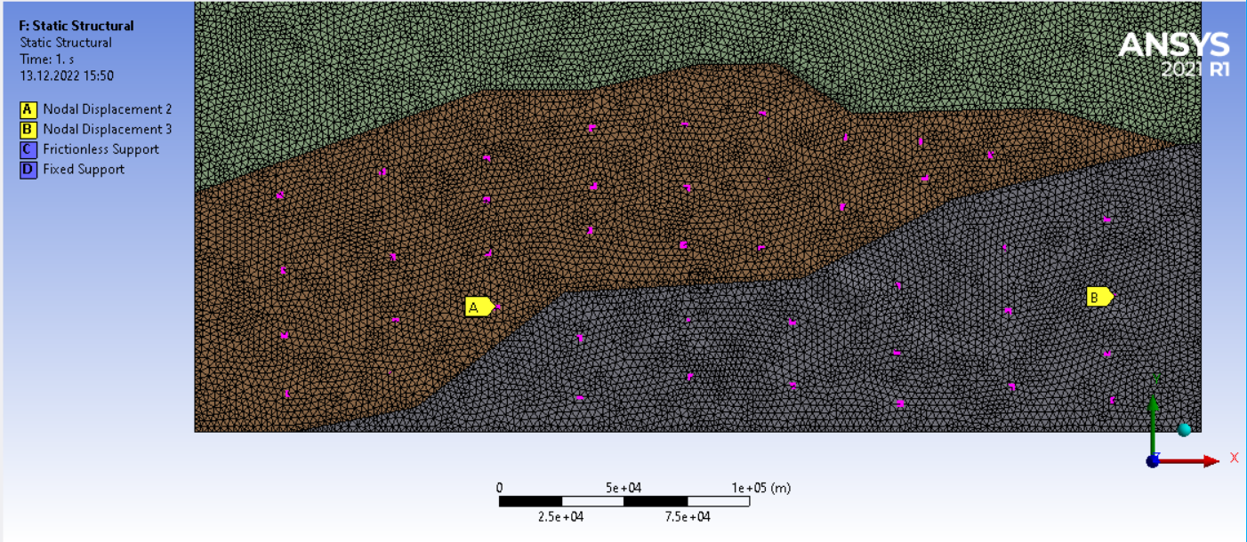

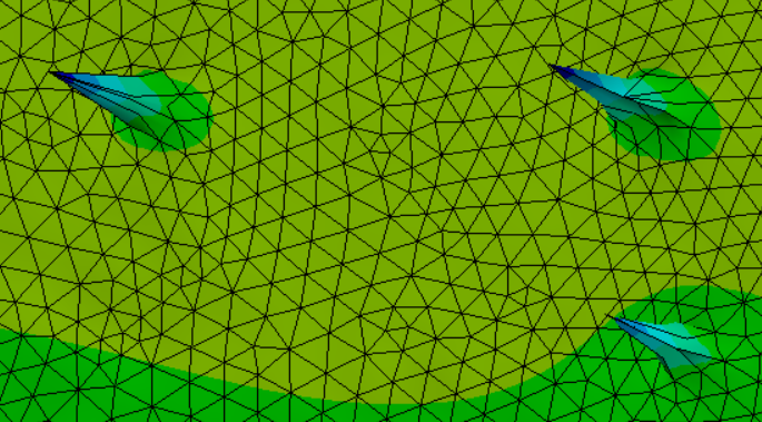

I've tried to solve static structural using nodal displacement. However; when I give displacement to the nodes (the nodes on the same surface but have different values), the displacement is equal to the entered values on that nodes, while this value is transferred to other points on the surface in small amounts. What should be done to make the nodal displacement value extrapolation or interpolation to the nodes that on the same surface?

SubscriberIt is better to apply loads and supports to areas not nodes when you have a solid element mesh. The reason is a point load represents an infinite stress because the area is zero.

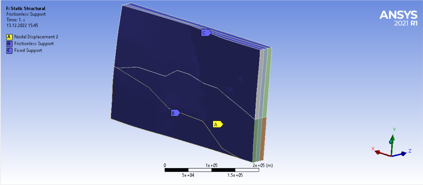

A and B are the nodal displacement, B is the frictionless support and D is the fixed support. There is 9 part. I defined bonded contact to the horizontal surfaces and to no separation contact to the vertical surfaces (I'll also try the frictional, and frictionless contact until the test nodes RMS that is calculated by using known and model result displacement values is minimum).Â

SubscriberIt looks like the Frictionless Support is on the same surface that the Nodal Displacements are on. That is why just the individual nodes poke up, the surrounding nodes are prevented from doing so by the Frictionless support.
It looks like this is a slab of terrain, hundreds of kilometers long. So the surface is not flat. I have only ever used Frictionless Support on Flat or Cylindrical geometric surfaces. I don't know how it behaves on NURBs surfaces.
Please explain what you are trying to model and why you are using a Frictionless support.

The frictionless support was applied bottom of the model to restrict the vertical movements. It is not on the surface that applied nodal displacements.Â
3D model is Earth structure, vertical surfaces are tectonic faults and the nodal displacements are GPS velocities. The velocities (per year values, so I use them as displacement) were determined relative to the northern part of the model from long-term GPS coordinates. I've tried to find the stress (per year) value on the fault lines.

SubscriberAh, okay, now I understand.
You can't use nodal displacements to pull single nodes on the Earth surface to match GPS measurements of the Earth surface.
You need to create a model of the Earth's crust that applies the pressure from below and from the sides to cause tectonic movement and adjust those boundary conditions until they have an acceptable match to the GPS measurements.
