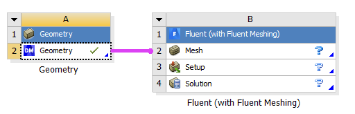

SubscriberI want to mesh my geometry by fluent meshing. The geometry was generated by Design modeler in
Workbench. But the geometry can not be loaded into the fluent (with fluent meshing). There is no workflow window when open the fluent (with fluent meshing), as shown below. Could anyone help me with that? Thanks!
August 25, 2020 at 9:06 amKeyur Kanade

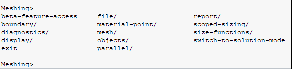

Ansys EmployeeWhich version you are using?nPlease check if you have switched on beta options. nIn TUI, you can switch on beta. nRegards,nKeyurnGuidelines for Posting on Ansys Learning ForumnHow to access ANSYS help linksnn
August 26, 2020 at 4:56 amrrh
SubscriberThanks for your help. The issue has been solved. I uninstalled the ANSYS 2019 and setup ANSYS 2020 (student version). It's OK now.nJuly 11, 2022 at 10:45 amtarabehmanesh
