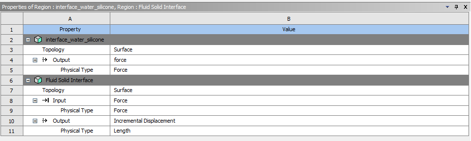

      Hello Ansys-Users:)
      Im doing a FSI simulation and Im wondering why my fluid surface has no "displacement"-input.
      Can someone help?
      Thank you very much!
      Greetings,
    • Rahul
      Is this a fluid side interface? Have you provided "via System Coupling" BC for that interface under dynamic mesh settings in Fluent?
