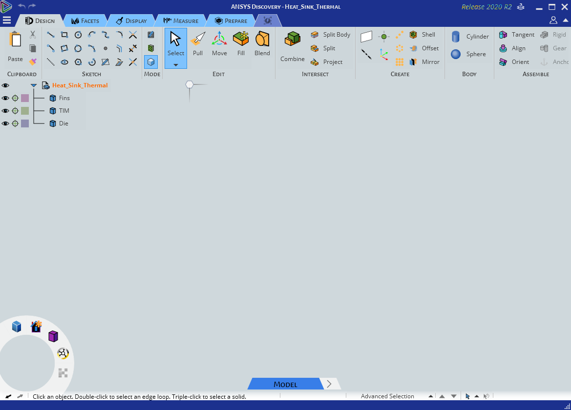

I do realize this is an NVIDIA driver issue, but I wanted to bring attention to an apparent issue with the latest GeForce Drivers (in this case Studio Driver 451.77). In short, the excellent Discovery 2020R2 loses its graphics entirely with this new driver. The older driver works OK, which is a mild workaround as this doesn't support the new Windows 10 Hardware-accelerated GPU Scheduling. Can you guys at ANSYS ping NVIDIA and look into it? Here's what it looks like:

SubscriberCharudatta Bandgar If I force Discovery to run off the Intel UHD Graphics card, the graphics are back. BTW, driver 451.48 is as bad as 451.77. I guess the whole 451 branch has an issue...

SubscriberCharudatta Bandgar Same as 451.77: Ansys Discovery (not Live) is not displaying any geometry/graphics

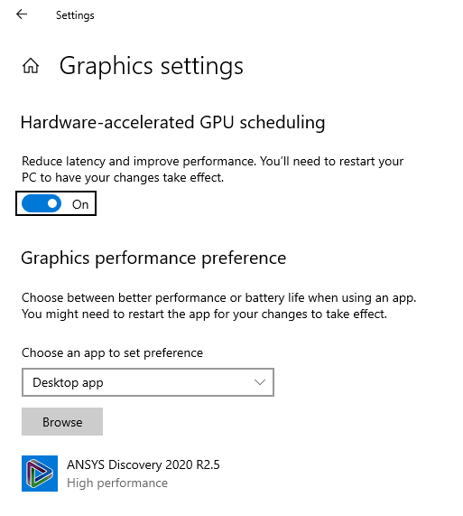

SubscriberI tried the Gaming Driver latest (451.67) to no avail, still no graphics in Discovery. Reverting back to 442.92 Studio Driver, the last one to work with Discovery... 3 months old driver that doesn't support GPU Scheduling on Windows 10 :-(
