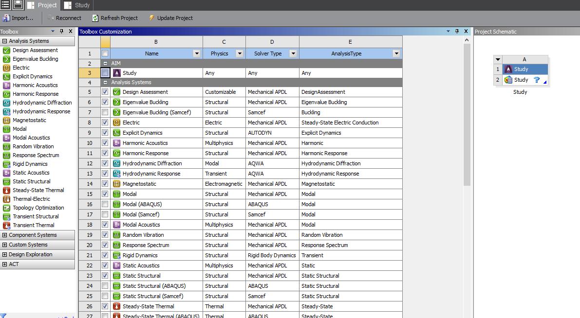

SubscriberHey guys.I am using Ansys 19 R2 student version.But there is no fluid flow options in the toolbox.How can I fix it? Thanks in advance.

Ansys EmployeeWhat exactly is the name of the installation package that you used to install this ?
It seems you used 'DISCOVERYAIMSTUDENT_2019R2_WINX64.zip'Â ?
If you are going to use Workbench, you must use 'ANSYSACADEMICSTUDENT_2019R2_WINX64.zip'
