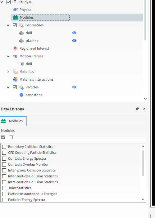

No bonded module in settings
    • javat33489
      Why can't I see the BONDED module? The module files are there, but I can't select it. Many modules are missing.

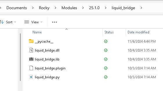

    • Lucas Bertollo Baggio
      please check on Rocky Tutorial 23 to verify if the files path is correct.
      example:
      • javat33489
        Yes sir, that's right, all the module files are located at this address.

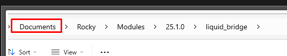

        But my DOCUMENTS are in a different language, not English. Could this be a problem?
      It should not be a problem. A possible workaround for this situation is following step 23.1.4.7 from Tutorial 23 and using this 'compiled_modules' folder for the modules.
