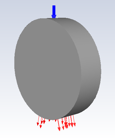

Below is a picture of the domain. I'm sorry I can't show the metal geometry inside the domain since I don't have the approval to share on a public platform. But inside the grey cylinder is a motor end winding geometry. Input is a jet nozzle (input volume fraction oil = 1). The outlet is at the bottom where the air inside and oil go out. I have enabled reverse flow at the outlet as well (air volume fraction = 1).
Answer your second question. My energy residuals are below e-8. All the other residuals are below e-3 except for continuity and k. Continuity fluctuates around 1e-1 and k is below 1e-2.Â
Also, I plotted the total heat transfer rate throughout the simulation. It changes a lot. Values fluctuate between to 8 to -12W (heat source = 23W). But my temperature readings are pretty stable they very between 3 degrees.Â
Really appreciate any advise you can give on this.Â

Forum ModeratorOK, continuity will be the key here. Add a volume monitor of VOF mass in the domain and see how that looks. I suspect it'll not be a flat line, and then look at the mass of oil in & oil out as two extra monitors. If you take the mass variation of oil, and know the heat capacity what sort of temperature change would you expect?Â

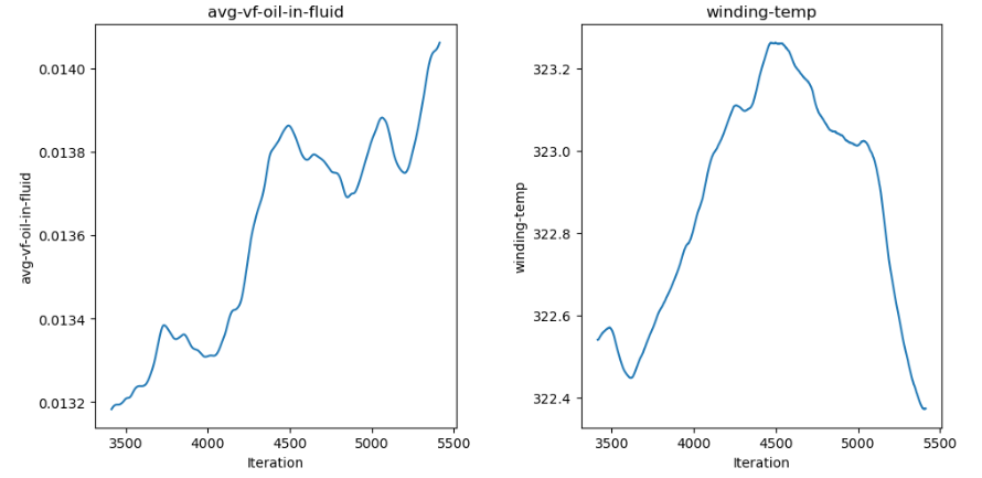

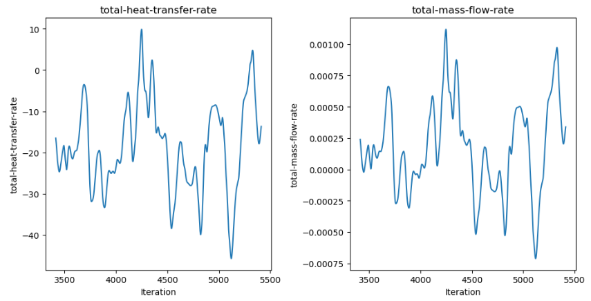

Thanks for the quick reply. I haven't used the exact monitors you mentioned and I will start a simulation with these today. In the meantime, I can show you a few similar monitors I have been using to check continuity.
All the graphs below are for the last 2000 iterations.Â
- total-heat-transfer-rate (W) - does not take the heat source (23W) to account
- total-mass-flow-rate (kg/s) - All input minus output fluid (oil and air), maximum mass imbalance is 8%Â
- avg-vf-oil-in-fluid -Â volume average of the volume fraction of oil in the fluid domain
- winding-temp (k) - Area weighted average of the winding temperature Â
As you can see the temperature value does not change a lot. I do not fully understand this part of your answer "If you take the mass variation of oil, and know the heat capacity what sort of temperature change would you expect? "

Forum ModeratorIf the heat source is 23W I'd expect the balance to be around -23W as more heat leaves than enters through the boundaries. That more-or-less ties up with the graphs.Â
If you check the (total imbalance * cp) what sort of values do you come out with? Temperature may not change much if most of the heat finishes up in the oil as it'll have a relatively high heat capacity compared to air.Â
The domain oil fraction isn't looking to be entirely at equilibrium, but I appreciate this is shorter plot than the whole simulation.Â

Yes, I would expect it to balance around -23W as well. But as you can see the values deviate a lot.Â
The specific heat (Cp) of oil is around 1600 J/kg k. At 5000 iteration point, total mass imbalance * Cp = 0.6522. The total heat transfer rate imbalance at this point is 12.5 W (net value considering the heat source).Â
You are correct about the domain oil fraction. It does not look like it's at equilibrium. But since the temperature change is small it doesn't seem to affect much.Â
August 14, 2023 at 12:30 pm
Rob
Forum ModeratorIt's not an unreasonable dT compared to the overal variation in the domain. Especially as there looks to be slowly increasing amount of liquid in the volume.Â
I suspect it's mostly convergence.Â
