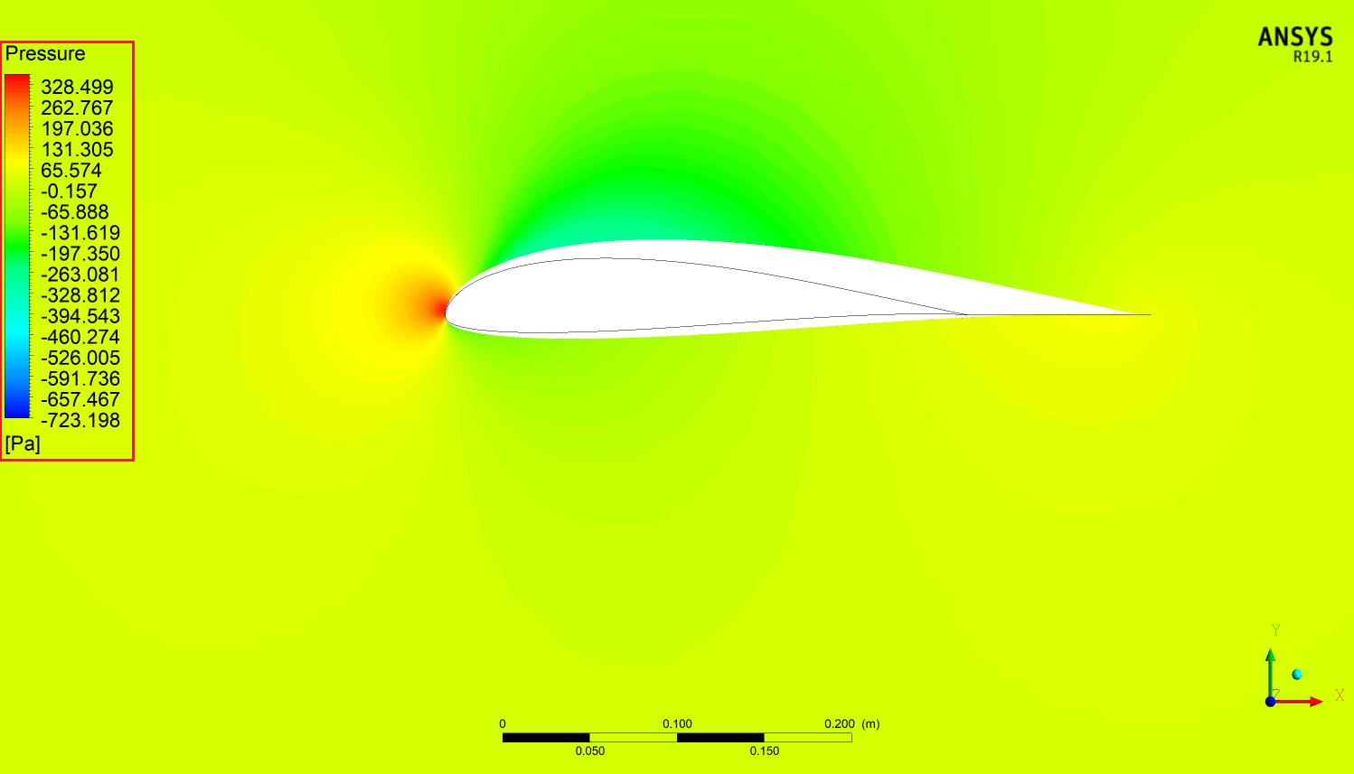

      I have run a CFD simulation using FLUENT on an airfoil for pressure distribution as shown in the picture below.
      On the other hand, I do not understand the NEGATIVE PRESSURE values of as shown in the legend, why do I have negative pressure?
      And what is this pressure: total, static, gauge, etcpressure distribution on airfoil wing
    • Amine Ben Hadj Ali
      Look into absolute pressure.
    • Rahul Kumar
      Plot velocity vectors too for better understanding of negative pressure. Refer to the Fluent Theory guide for the definitions: https://ansyshelp.ansys.com/account/secured?returnurl=/Views/Secured/corp/v201/en/flu_th/flu_th_sec_compressible_physics.html?q=total%20pressure
    • AlfredOloo
      Seems like it is absolute pressure.
      Thank you
      What do you mean?
    • AlfredOloo
      I mean the pressure values given here seem to be absolute pressure and not gauge. Am I right?
      Please check the absolute pressure in Fluent whether is negative or not.
