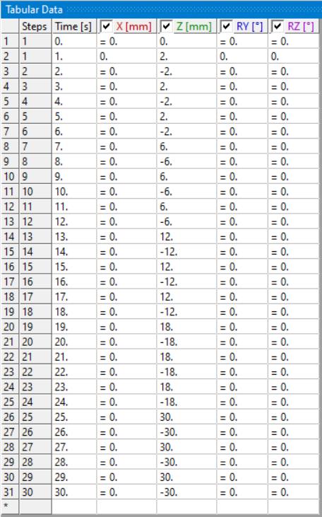

      I'm looking at the Remote Displacement load.
      This is pushing and pulling on the top of the structure with larger oscillations of displacement.  Why are you doing that?
      It is the worst idea for efficiently solving the deformation of the structure out to the limits of displacement.
      A much better idea is to have a single step that goes out to 30 mm.
      Perhaps you are trying to build up plastic strain. You don't have the correct material model to accomplish that. You must use Charboche.

      About "This is pushing and pulling on the top of the structure with larger oscillations of displacement.  Why are you doing that?" , I want to do cyclic analysis to the structure following testing procedure from ATC and AISC until the material become plastic.

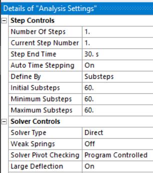

      Dear Kevin,
      I don't have a copy of the testing procedure from ATC and AISC so I don't know what you want to simulate.
      Do a Save As to a new file name so you can go back to your initial model later, after you have read more about Charboche.

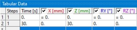

      You can use the material model you have to find out the tip displacement when plasticity begins.
      You do that by having a single step with an End Time of 30 s and a single value for the remote displacement: 30 mm.
      Under Analysis Settings, make sure Large Deflection is On.
      Turn on Auto Time Stepping.
      Set the Initial, Minimum and Maximum Substeps to 60.
      This will give you a data point about every half mm.

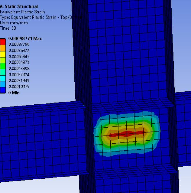

      Click on Solution and request an Equivalent Plastic Strain.
      The Plastic Strain result will be zero for small displacements while the material is in the elastic region, then it will be non-zero when some elements reach the yield stress.
      The time in seconds when the plastic strain goes above zero is the value of displacement in mm since the end time and displacement values were equal.

      Anyway how to setting time duration in one single step, because i can't edit it. each step default time is 1 second.
      Is there any video or tutorial about this?
      Kevin
      Here is what you had and what you want.
      Edit the Remote Displacement, select all the rows except the last one and delete rows.

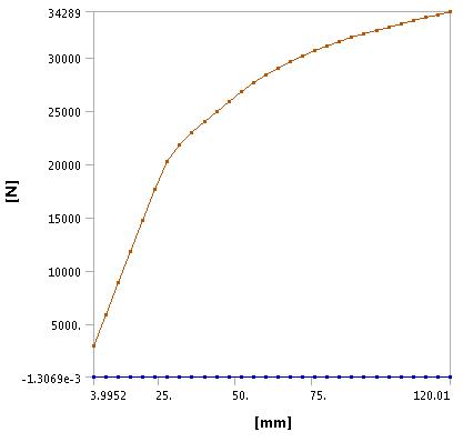

      My research goal in ANSYS was to verify existing experiment.
      The experiment was a laboratory test, the test setup looked like my model,
      this experiment simulate cyclic loading with hydraulic jack pushing and pulling at the top.
      One of the experiment result was a "load vs displacement" diagram.
      What conclusions were drawn from the experimental data?

      Besides that conclusions were drawn from the experimental are usually behavior (plastic deflected shape), displacement (to plot load vs displacement), and stress (to indicate yield).

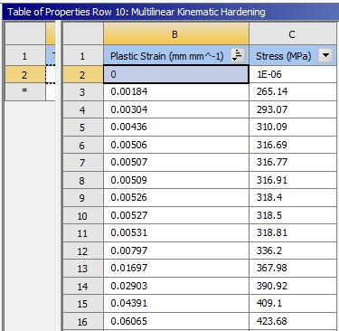

      Just information for material properties i'm using kinematic hardening condition.
      Where did you get the data in the multilinear kinematic hardening model?
      The convergence problem is because you put 1E-06 as the entry in cell C2. That value should be the Yield Strength.
      Do you know the difference between:
      • Engineering Stress and Strain
      • True Stress and Strain
      The values in that table are supposed to be True Stress and Strain.

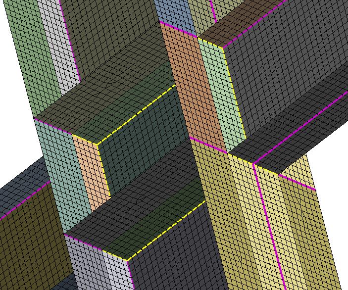

      I recommend you insert planes in DesignModeler and Slice the geometry up to get regular shaped elements like this:
