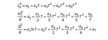

   How could i include Thermodynamic data which is in NASA code format in Ansys FLUENT? If it is using thermo.db file available in fluent property database library then where is the option to include the file in Ansys FLUENT software?
please kindly give me some suggestions.

SubscriberSir, also i would like to clarify, if i adjust the material property of Cp from NASA polynomial into user defined material database then would i be able to get correct values of standard state of enthalpies and entropies.
Please kindly give me your suggestions.
Thank you
March 4, 2020 at 9:31 am
Amine Ben Hadj Ali
Ansys EmployeeEntropy yes but SS enthalpy is something different: That your input. NASA polynomials are already there for the components you have. Just use piecewise-polynomial.

SubscriberOk Sir....Is there an option to include enthalpy and entropy as piecewise polynomial in Ansys FLUENT?? I couldn't find any option to include enthalpy piecewise polynomial option in Ansys FLUENT ? Please kindly give me few suggestions.
Regards
Sowmiya -
March 4, 2020 at 5:50 pm
Amine Ben Hadj Ali
Ansys EmployeeWhy? Entropy is deduced from Cp. Standard state enthalpy can be scripted via scheme but is not relevant as it a standard state enthalpy. -

Ansys EmployeeCheck physical properties and field functions in the users guide. You will then see that its deduced from Cp.
If you want to code your own you need to use UDRGM.
