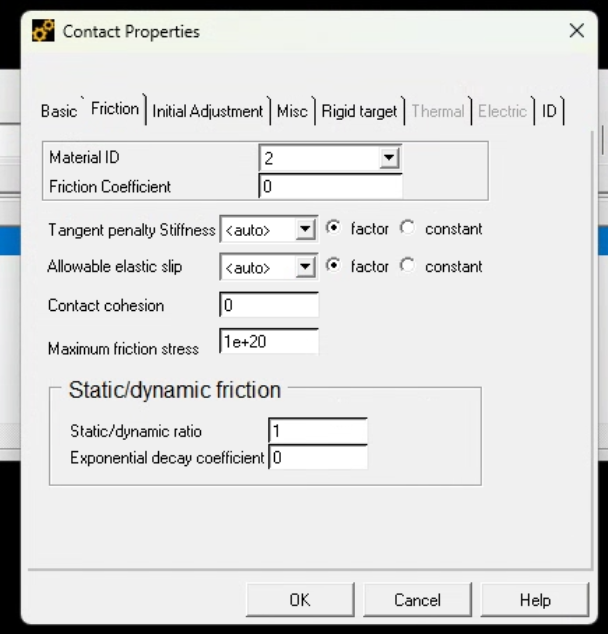

- I’ve been using a linear elastic material model. “
MP,EX,2, modulus1
MP,PRXY,2, poissonratio1
” The rubber block was set to have a 1GPa modulus and a 0.4 Poisson ratio. Unfortunately, I don’t have any data to share, and I am just hoping to get the simulation results for the load-displacement curve. - For the rubber, I have the following for KEYOPT: “
ET,1,PLANE182
KEYOPT,1,1,0
KEYOPT,1,3,1
KEYOPT,1,6,0 “ - Sorry about the confusion. The material outside 4mm is still the rubber block. I split the whole block into 3 parts so the mesh gradient goes from extremely fine to coarse.

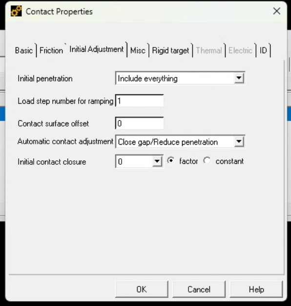

- All the parts have been glued together and the contact pair (indenter and rubber block) was set as frictionless. And yeah, the bottom of the rubber block was set to be able to move freely in the horizontal direction.

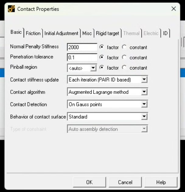

- The radius of the indenter was 1.19mm and it was set as rigid in contact pair. And the basic settings for contact pair are shown below, the reason why I have 2000 normal penalty stiffness is that I want to minimize penetration into the surface:
Thanks!

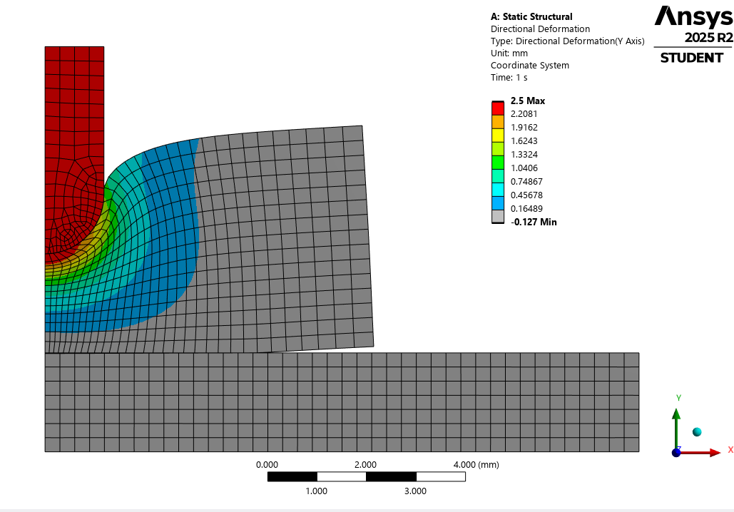

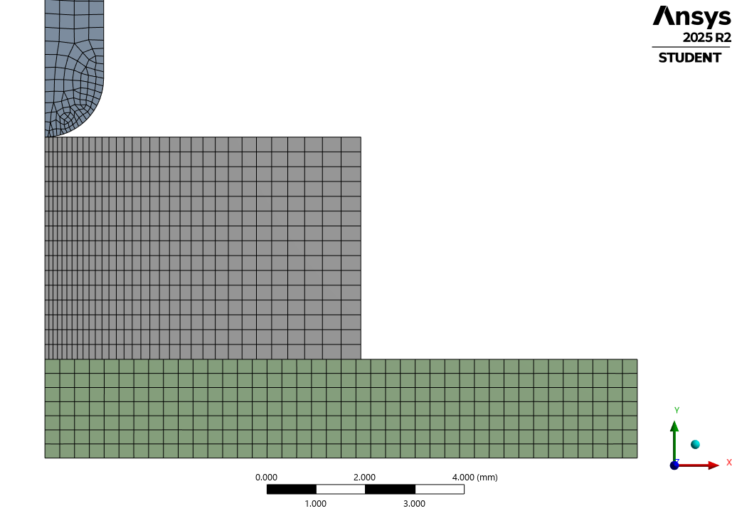

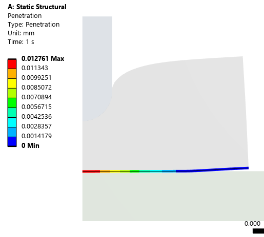

SubscriberMake a linear element mesh that is biased to the Y axis horizontally, but uniform vertically. You want tall, skinny elements on the Y-axis as shown below. Make the rubber disk from a single face, there is no need to split the rubber into multiple faces. There is no need for Nonlinear Adaptive Meshing. Under the rubber disk, add a base part so the rubber can lift off.
Under Engineering Data, in the Explicit Materials category, add the material called Rubber1 that uses an Ogden Hyperelastic Material Model and assign it to the rubber disk.
I set Frictional contact between the indenter edges and the top edge of the rubber to have a Coefficient of Friction of 0.2 and did the same between the top of the base plate and the bottom edge of the rubber. Set Auto Time Stepping to On and use 50 Initial and Minimum Substeps, with 500 Maximum Substeps. Turn On Large Deflection.

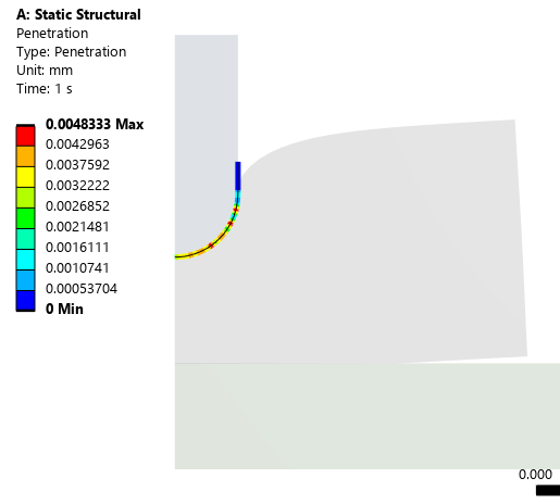

With default settings for the contact, the Penetration is less than 0.005 mm at the indenter.

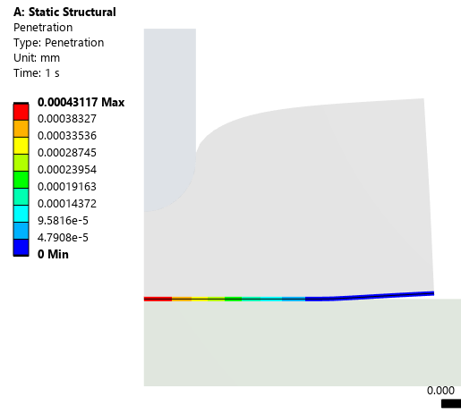

However, the penetration is larger on the base plate.
By setting the Penetration tolerance to 0.001 mm, the new solution shows a much smaller penetration.
Good luck!

Subscribersorry one quick question, did you set a value for the normal stiffness or just program controlled?
May 21, 2026 at 7:04 pm
peteroznewman
SubscriberI used Program Controlled for Normal Stiffness, however, when I changed Penetration Tolerance, the way that was accomplished internally is by increasing the normal stiffness.
