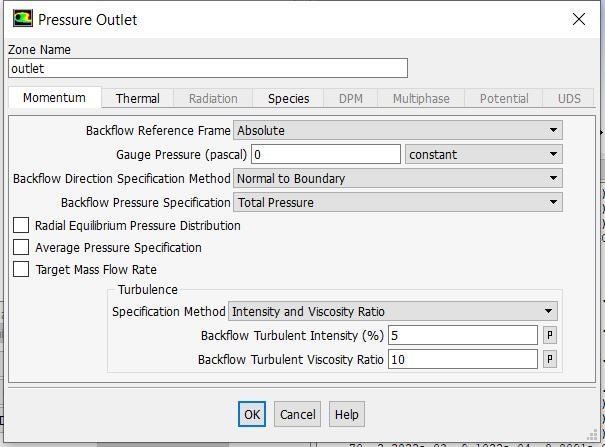

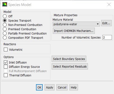

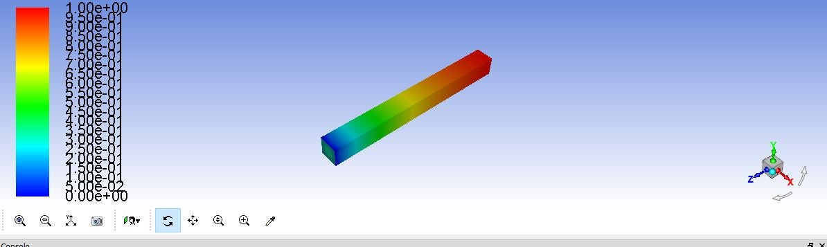

SubscriberHello!nI'm trying to simulate the diffusion of polystyrene nanoparticles in a microchannel filled with water.npolystyrene nanoparticle in a water medium is introduced at the inlet of the channel.nNanoparticles travel through the channel via diffusion and I'm trying to simulate their motion using Ansys fluent.nI tried to use the species transfer model with inlet diffusion enabled, and I noticed backflowoccurring at the outlet of the channel. I defined the channel outlet as outflow but still there was backflow at the outlet.nI have attached snaps of the species transfer model settings and the resulting contour of polystyrene mole fraction along the channel.nCan someone tell me how to avoid backflow in the channel?nAlso, is there a better model to use for this simulation?nThank you!nnn

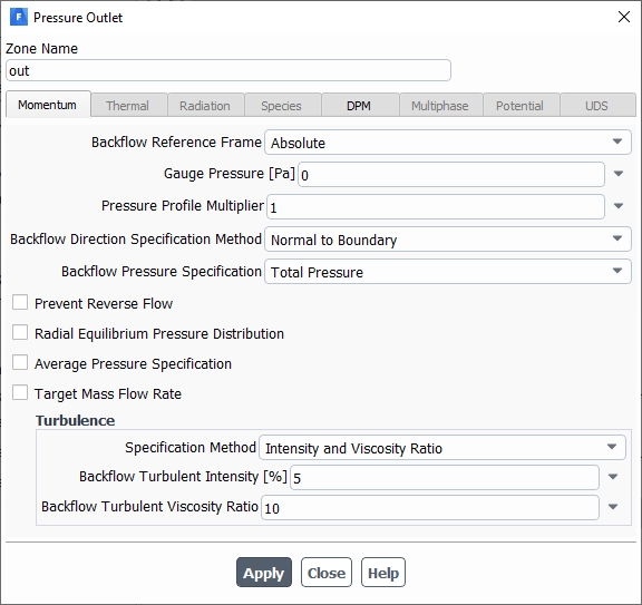

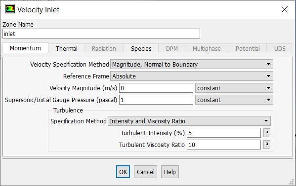

Forum ModeratorThere's a flag in pressure outlet to prevent back flow. If the inlet velocity is zero chances are the backflow is numerical, ie the velocity will be +/- a very small value as the solver converges each time step. n -

Forum ModeratorWhich solver version are you using? n -
April 26, 2021 at 9:51 am
Achini
SubscriberDear sir,nThank you for your reply.nI'm using Ansys workbench version 18.1. nI guess that option is not available in the version I'm using. -
April 26, 2021 at 10:12 am
Rob
Forum ModeratorIt's not, you need to update to a more recent build. R18 is 5 years old now. n -
April 27, 2021 at 5:37 pm
Achini
SubscriberI installed Ansys workbench 2021 R1 and could eliminate reverse flow using that version.nThank you very much for your support sir!n
