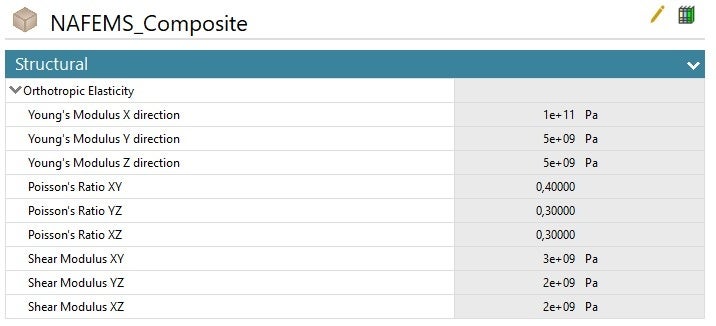

SubscriberHello,
I wanted to replicate the NAFEMS composite laminate benchmark test as described in this link:https://classes.engineering.wustl.edu/2009/spring/mase5513/abaqus/docs/v6.6/books/bmk/default.htm?startat=ch04s09anf81.html)
I recreated the composite part using ansys acp and conducted the study using static structural with boundary conditions and loading as described in the source material. However I am not able to get the same deflection as the NAFEMS result. I have attached few screenshots to help. Where can the mistake be ?
February 28, 2022 at 4:05 pmErik Kostson
Ansys EmployeeHi
This benchmark exists in the Ansys verification manual:
VMR031-T1 281 Input Listing (ansys.com)
Hope this helps and
All the best
Erik
