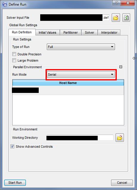

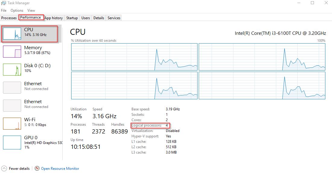

      I guess you were running in Serial. Attached are few screenshots on where to set your parallel solving information. And the maximum number of processors you can allocate can be found by knowing the number of logical processors in your computer (see attached screenshot).
      PS: MPI - Message Passing Interface. "MPI is a communication protocol for programming parallel computers."

      I believe Intel MPI has to be setup separately. But you got it right so worries !
