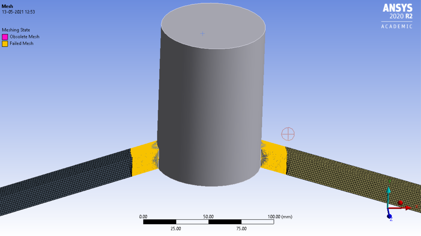

SubscriberI'm meshing this geometry in which I wish to give a Hexa/Prism Multizone method to the cylinder. But upon generating the mesh I'm getting the erros
1.) MultiZone blocking decomposition failed
2.) A mesh could not be generated using the current meshing options and settings.
May 13, 2021 at 8:04 amKeyur Kanade
Ansys EmployeeSplit this body further.
Please check following videos
Ansys Meshing: Decomposition for hex meshing:
https://www.youtube.com/watch?v=P19GOTQWmc0
Regards Keyur
May 13, 2021 at 8:47 am_aryaman
SubscriberThankyou very much, it worked.
